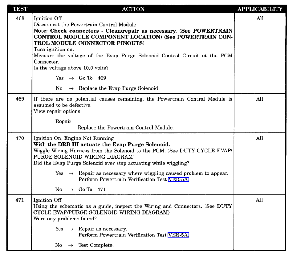

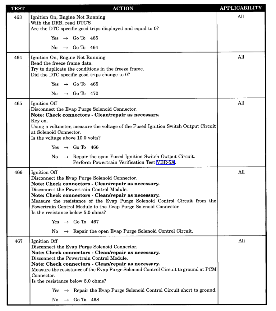

Still have the P0443 code, bought a new purge valve solenoid but doesn' work so I checked alldata (DIY) and found a series of test (i'll attach) and performed them and this leads me to a possible defective PCM.

Good newsss!!!! Used the jeep today, no case of no-start but I think I've found the P0443 problem. I tried to wiggle the pcm connector and the evap solenoid suddenly started to tick.
The next days I'll try the oscilloscope like you suggest, so in case of no-start I know what to look for but in the meantime how do I know if it's a bad PCM or a bad connector? How do i test the connector?

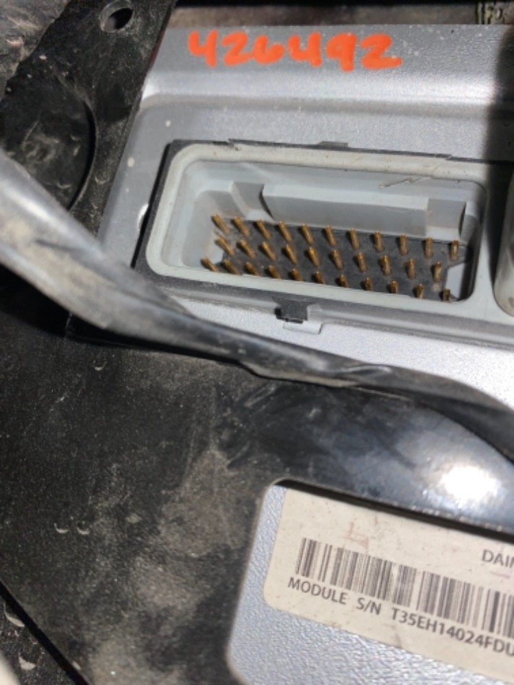

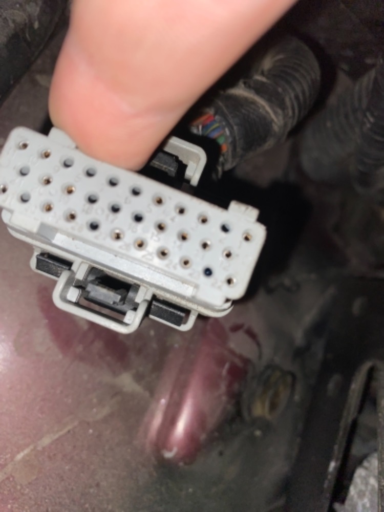

Out of curiosity, have you unplugged that PCM connector and taken a closer look at the connections on both the connector & PCM? You should inspect them with a flashlight & look for any damage or corrosion.

- Will91Jeeper
- Posts: 8
5 years 6 months ago #48544
by Will91Jeeper
Replied by Will91Jeeper on topic Re:Jeep Grand Cherokee '99 4.7 WJ random crank no start
Used the Jeep today and still P0443 code, tryed to wiggle connector but didn’t work today so I tried this, I heated up the pin 20 the evap purge valve control pin, pulegged in the connector and now works if I wiggle it. I believe it’s a bad pin solder in the pcm
