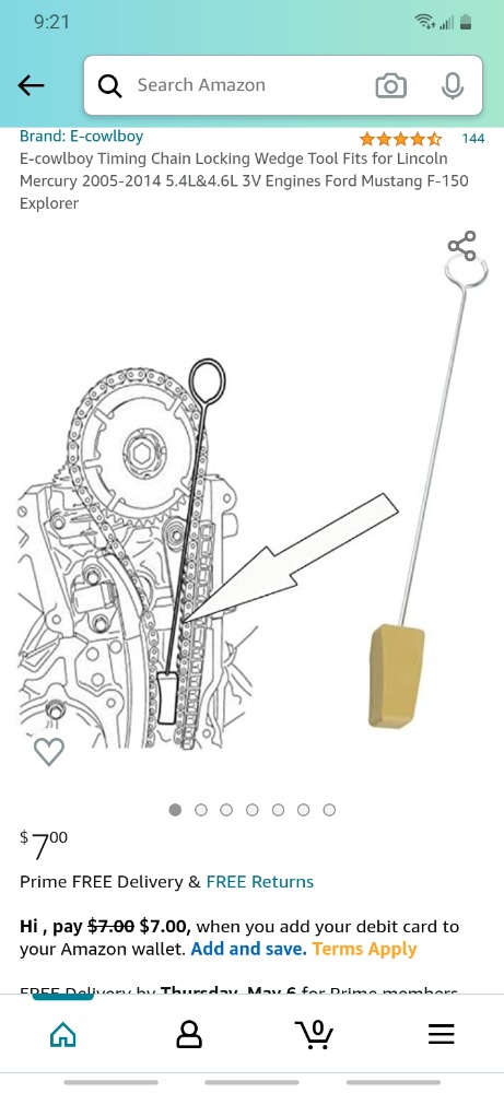

Tyler wrote: If the lobe is damaged, it's time for a camshaft, IMO. Camshafts can usually be replaced without timing cover removal.
I did a single roller rocker in a Pentastar at my last job.
Used a tool designed for Ford modular v8s and didn't even need to pull the camshaft. But it hadn't eaten the cam lobe yet.
Do you use some kind of wedge when changing the camshaft, like this one?
Last edit: 5 years 6 months ago by Noah.

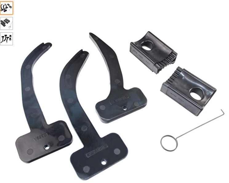

5 years 6 months ago #48503 by Tyler
Replied by Tyler on topic Re:3.6 Pentastar rocker arm
Noah wrote: I did a single roller rocker in a Pentastar at my last job.
I've done the same. I think it all comes down to how quickly the vehicle owner brings it in.
Yep, same idea. I dunno if this is the exact set I used? But it's close enough:
www.amazon.com/DPTOOL-Camshaft-Phaser-Ti...rysler/dp/B07RNNXJ3N
I’m going to pick that up just because even if I never use it it’ll be nice to have in case I do.
I just ordered this exact set last night.
