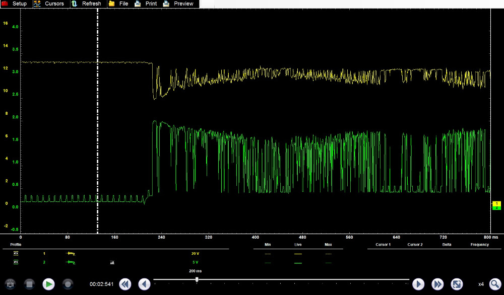

The behavior you're describing sounds very typical of a starter with high resistance in the brushes or open motor segments. For perspective, I took this capture off an '08 CR-V. This one had a very slow crank, and eventually died in the bay during testing. Yellow is battery voltage, green is starter current:
www.scannerdanner.com/forum/diagnostic-t...-i-m-right.html#9818
