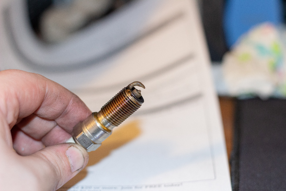

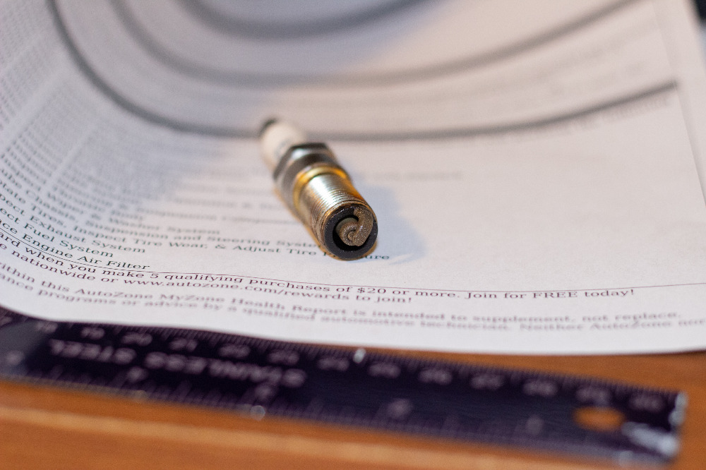

I know little about fixing cars but I'm not shy of learning a thing or two. My work car has been reliable up until this point. It's a 2004 chevy classic about 235,000 miles. 2.2l ecotec l61
Couple months leading up to this point I noticed a sort of "puffing" or soft "popping" sound coming from the tailpipe intermittently. Not a bang or anything. I also noticed one day looking on the ground that there seemed to be some black material that looks like it may have been blown out of the pipe a few feet from it (my first instinct was soot). But it still drove okay. Today I get in the car and I have a VERY noticable misfire along with accompanying blinking CEL. There is a consistent rhythmic "putting" sound coming from the exhaust at idle and while revving. The car shakes(puts along) and even moreso accelerating from a stop. I don't own a code reader so I borrowed one from autozone.
P0172 System Too Rich (Bank 1)
P0302 Cylinder 2 Misfire Detected
P0442 Evaporative Emission System Leak Detected (small leak)
My initial assumption was that the misfire was a result of the rich condition but I'm not sure.
Today I went and got hold of a fuel pressure tester and here's what I got.
KOEO prime: 54 psi
15 minutes later: 51 psi
turning on the car it idles at 60 psi
revving the engine it stays at 60 psi
I removed the vacuum line from what I assumed was the regulator and noticed no fuel coming out of it. (round thing on end of rail) I also noticed there doesn't seem to be any vacuum coming from the hose that lead back to the plenum. I didn't verify this with a tool, I just used my finger to feel for it. I don't know why there would be a vacuum hose where no vacuum was but that's why I'm here asking someone who knows more than me lol.
I'm just spit balling, I need direction. Where do I go from here? Is it reasonable to start looking at ignition system components or have I not correctly/sufficiently/reasonably assessed the fuel system? (at least that of which is reachable under the hood)

Are you getting spark at number 2 cylinder?

Remove the coil use spark tester check for spark while cranking

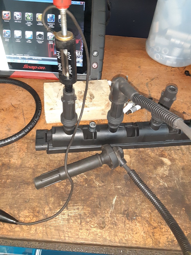

I went and bought a spark tester light earlier along with a compression tester.
Just so I'm understanding it would be a safe and valid test for me to disconnect the coil pack assembly from all plugs and insert the tester between the coil and plug one cylinder at a time while the engine is running? Could I also look for spark with a screwdriver at the end of the coil or can that damage anything?

I laid the coil pack on it's side with the 4 outputs about a quarter inch from the grounded valve cover. Cranked the engine and #2 did in fact NOT have any spark at all while the other three did. I haven't put the replacement in yet but I really hope this fixes the misfire, I'm sure it will. Thanks guys! As for the rich condition, I'll look into that shortly after I get this new coil put in. Like was mentioned here could be two seperate issues.

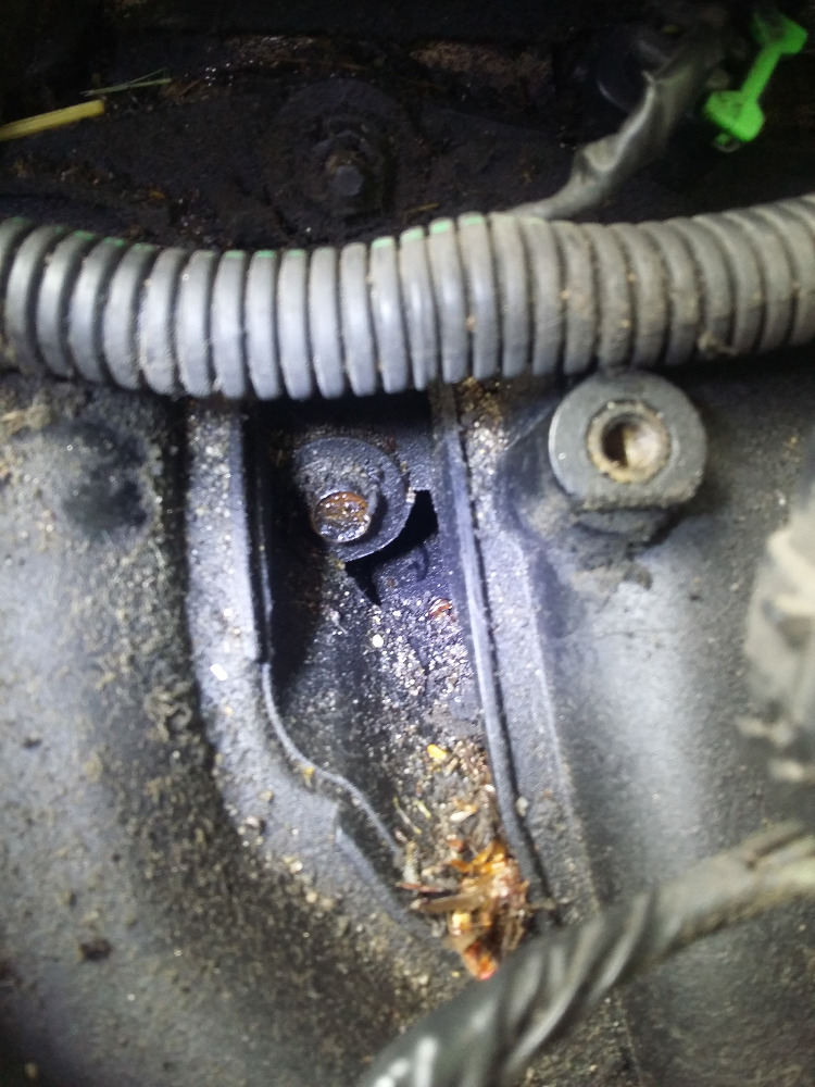

That hole in the intake manifold looks too clean but I checked ebay images and it's normal. Phew.
imgur.com/a/g1XsYxi
