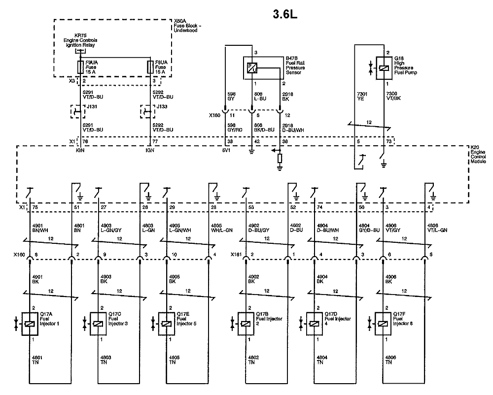

Good day all. I’m getting my but kick by this lacrosse. Here’s my situation. The car has a misfire on injectors 3,4 and 6. It’s powered and ground by the ECM. All of the injectors are good. I put a Noyd light on them and that’s how I know the ones that aren’t working, in doing my testing I now know that the injectors mentioned above are not getting power from the ECM. I did a continuity test on the wiring and they are all good. My question is how do I test the computer to see if it’s the problem? I am kinda confuse with the resistance testing but I’m watching and reading more in that area, any direction right now is appreciated. Thanks. I’m wondering if the driver in the ECM is gone but wanna be sure because the ECM is very costly. Thanks everyone

Are you missing power or ground?
5 years 6 months ago #48648 by Ben
According to diagram fuses f9ua and f8ua are responsible for fuel injection have they been checked?

Hey Ben thanks for responding. Am missing power from injectors 3,4 and 6

5 years 6 months ago #48686 by Da Beginner
Yes they were, and both are good
5 years 5 months ago #48689 by Noah
Like Ben noted, power is not directly supplied by the computer, but rather by a fuse. If the fuse has power as you say but the injectors do not, then there is an open circuit between the fuse and the injectors.
What is the definition of the trouble code you posted? I tried looking it up but found no p1255...
5 years 5 months ago #48691 by Ben
Actually we were both wrong in assuming it was all time power feed supplied by fuse.... diagram shows those 2 fuses supplying the pcm with power and a driver on power and ground? I'm not sure why maybe the inductive kickback of the gdi injector?any rate ill get pcm pin later to check for power at pcm I suspicion its the power supply circuit as that would affect a bank a pcm issue would likely be isolated to a single injector.
5 years 5 months ago #48692 by Ben
5 years 5 months ago #48693 by Ben
Check pin 76 and 77 at pcm for 12v with key on (both purple with dark blue stripe)

Thank you so much for your feedback. We had move it to the side for a while, but the problem was the ECM wasn’t firing the injectors or should I say” grounding” new ECM on the way so we’ll let everyone know how it go.
