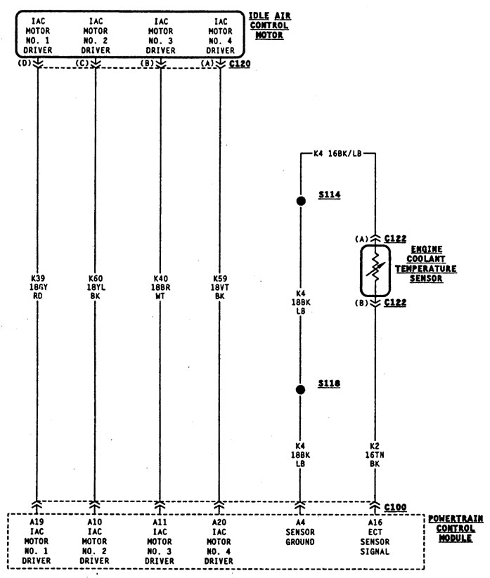

5 years 6 months ago #48676 by Ben
Good catch Cheryl! Sounds like your looking at the IAC it is a stepper motor 12v doesn't surprise me there

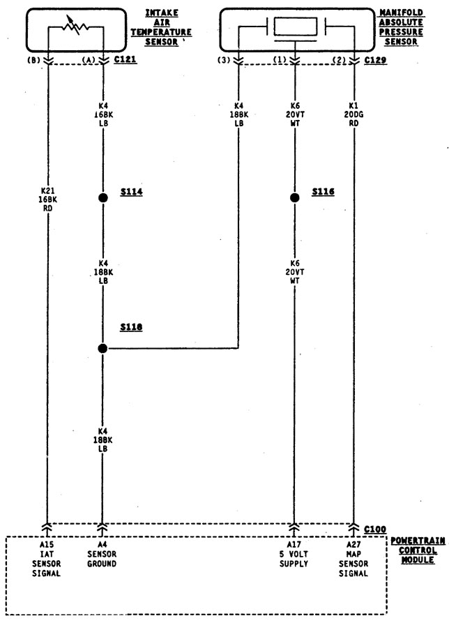

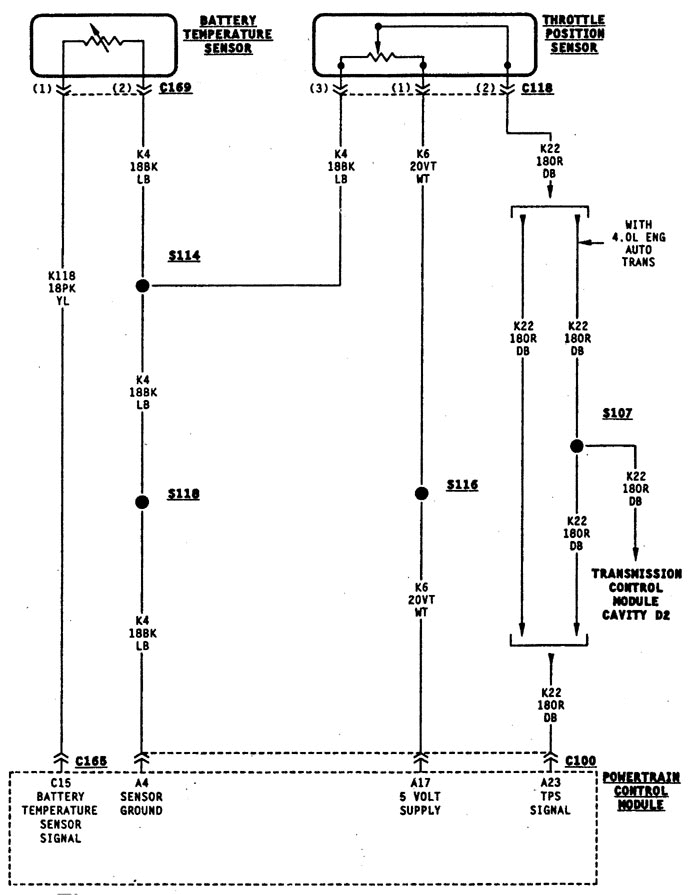

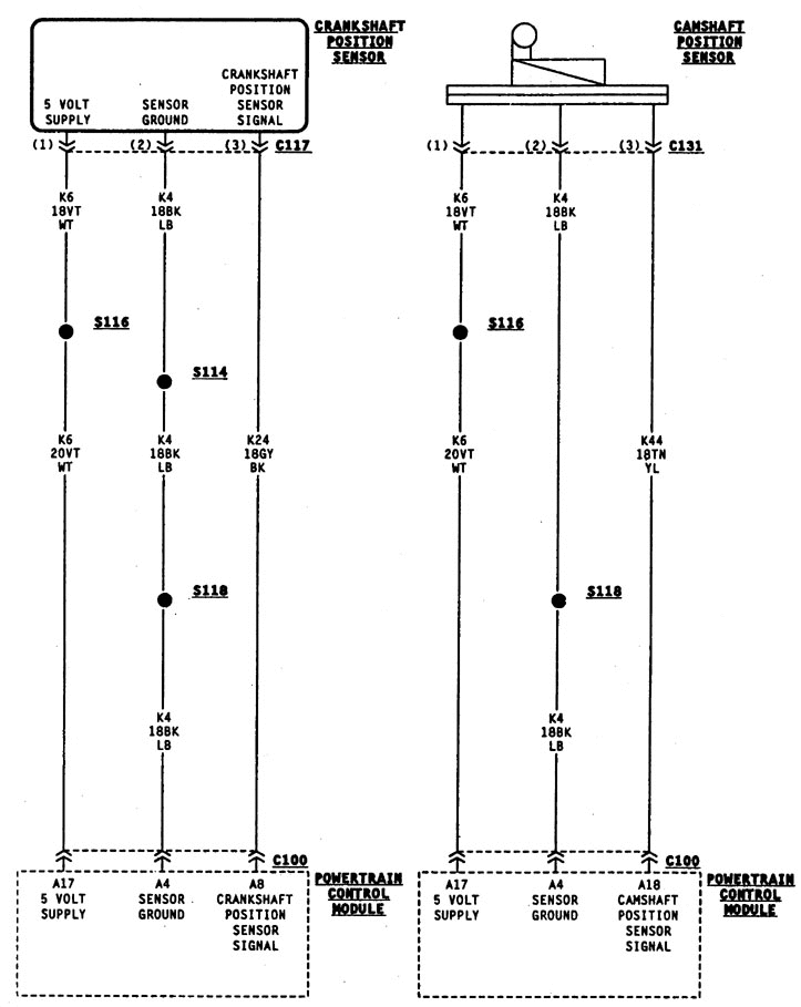

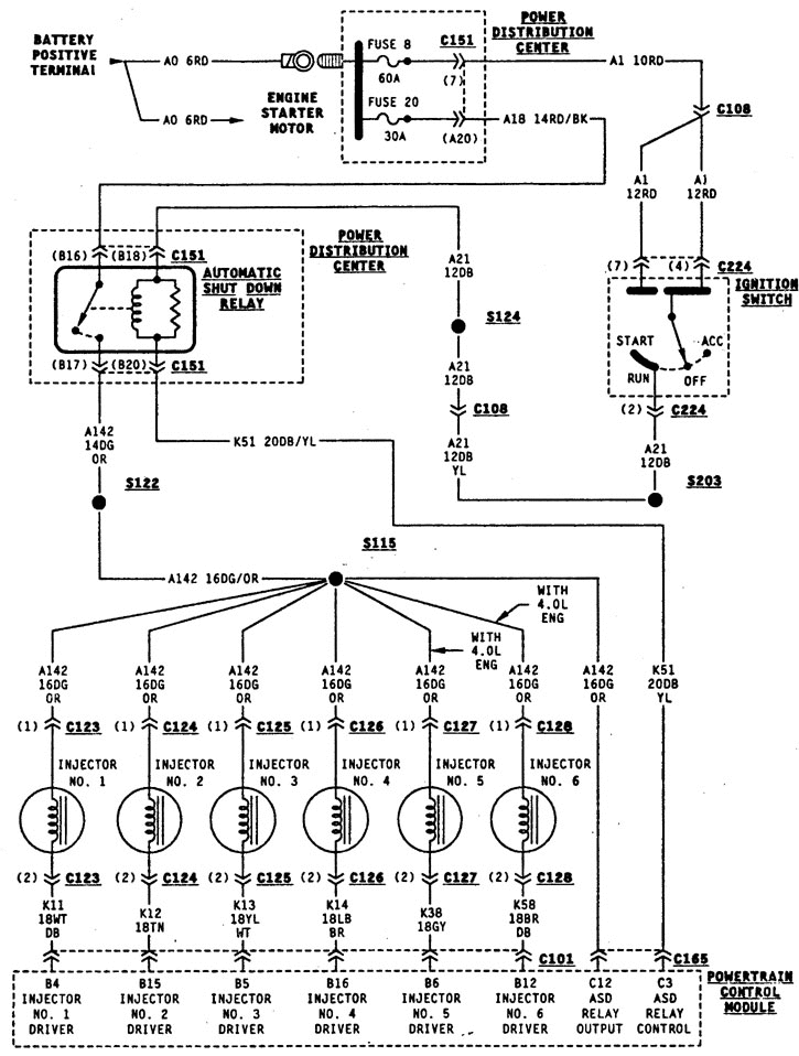

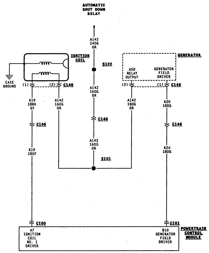

5 years 5 months ago #48694 by Ben
I think if were missing power to the coil and this is a no start symptom were chasing we should start there. the coil is supplied power from the auto shutdown relay (i hate these chryslers ASD) heres some relative diagrams to the stuff at throttle body and the coil power system
5 years 5 months ago #48695 by Ben
code 42 is for the ASD circuit the rest are random sensor circuit codes I suspicion you may have set some of these codes while testing?? I suspicion if you provide power to the coil and allow it to backfeed the whole asd circuit that it will run

5 years 5 months ago #48707 by Ben
seems like the diagrams didnt post earlier??
