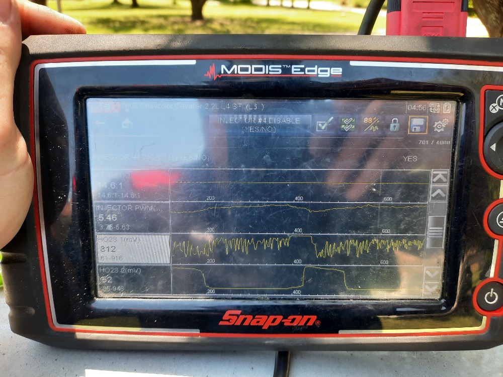

She runs GREAT going down the road. However at idle, the engine surges for 15 seconds, then kind of evens out for 15 seconds, the goes back and forth between those 2 conditions. Sometimes it's not that exact and it may surge for 45 seconds.
While idling rough and surging the upstream 02 stays fixed rich. Fuel pressure regulator did not fix problem, and I'm totally lost as to what it could be now. Electronic Scope Compression check passed too. Help? Lol

What are fuel trims reading?? Looks like front o2 is switching not flatlined at 900 mv or more
5 years 5 months ago #48731 by Cheryl
Replied by Cheryl on topic Rough idle/engine surging help!
Never mind I see it now. I think you have a bad front o2 sensor the rear one is dead lean
