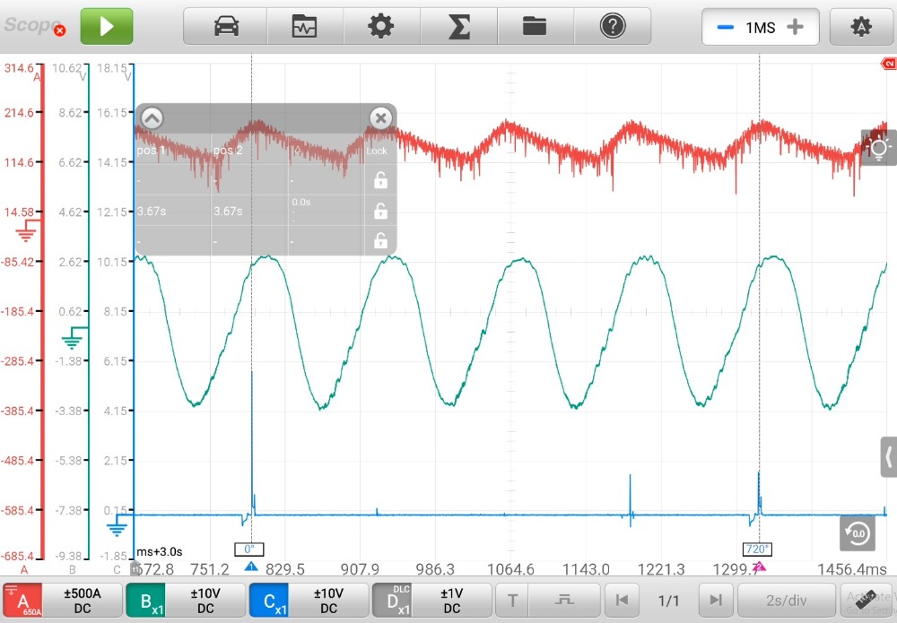

2009 Mazda CX-7 with a P0302. The misfire mode 6 data shows it misfiring very frequently at idle for the first 15 mins until the engine is warmed up. The oscilloscope wave shows the ignition coils and the fuel injectors all good. The car has new spark plugs. The misfire stays on cylinder 2 even after moving coils and plugs around. Any help is greatly appreciated.
Thank you.
Brian

5 years 5 months ago #48811 by Tyler
Replied by Tyler on topic 2009 Mazda CX-7 P0302 Misfire At Idle Only
BLEE wrote: I have a pressure transducer; would that work?
Which one, exactly? A Pico WPS500 would work, but a Fluke PV350 would not.
What do you exactly mean by a pressure pulse sensor in the intake?
A delta sensor, First Look Sensor, like that. It's a canister with a piezo disk that's very sensitive to pressure changes. This is a known good capture taken off a '15 Equinox. Relative compression in red, intake pulse in green, #1 sync in blue.
Would this cause the misfires to only happen when the engine is cold?
Absolutely. Carbon deposit issues usually show up worse when cold.
There are other issues that can cause that, of course, like a leaking head gasket or intake manifold gasket. Intake gaskets are pretty solid on these, IMO. You can check for a head gasket by getting the engine hot, pulling the plugs and pressurizing the cooling system overnight. Look for coolant in the morning.
