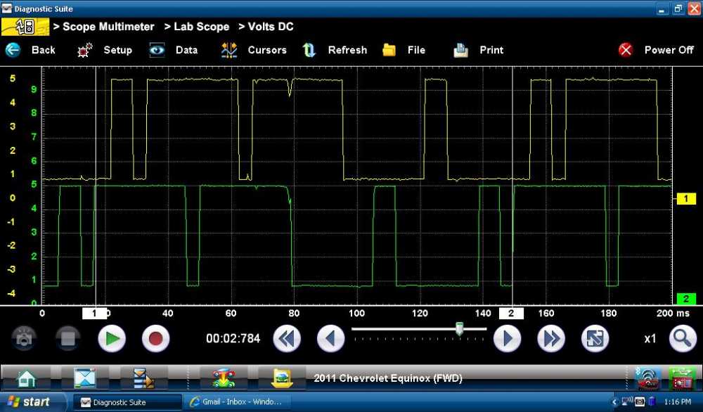

Anyone have a known good scope capture of the intake and exhaust cam sensor correlation I haven't had time to check vs crank sensor yet

9 years 7 months ago #6701 by Tyler
Replied by Tyler on topic Re:08 Malibu 2.4 p0017
Sorry for not getting back to you sooner, Ben!
I've got this capture from an Equinox with the 2.4L. Exhaust cam in green, crank in yellow. I have an intake capture, but it was out of time, and not a good reference. :lol:
For what it's worth, I don't even scope the cam/crank for these correlation codes anymore. ;) Not saying you were wrong to! But every time I've seen this code, there has been a genuine timing issue.

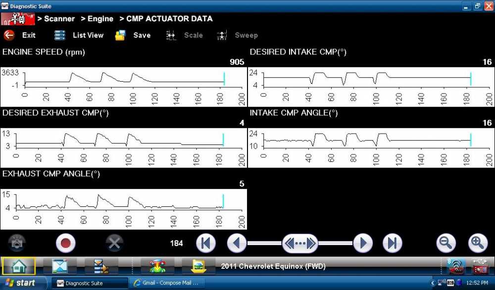

9 years 7 months ago - 9 years 7 months ago #6753 by SniperDan
Replied by SniperDan on topic Re:08 Malibu 2.4 p0017
These engines are HIGHLY prone to defective cam actuator solenoids. These solenoids are pulse width modulated, with both wires going to the engine computer. They are pulsed on the positive side. Given that you don't have a circuit fault code, I would closely inspect the engine oil for proper level and quality. I have seen these solenoids get gunked up and cause oil flow issues to the phasers, subsequently causing correlation fault codes. An easy way to catch this is to monitor desired vs actual camshaft position, and rev the engine at idle in park. You should see changes in both commanded degrees, as well as actual on a working system. If the affected cam is slow to respond to command changes, or totally unresponsive, this again points to a solenoid or oil quality/level problem.
Interestingly enough, I just had a 2011 Equinox roll in for the very same fault code. (Just kidding, I lied, see post further down, my actual fault code was a P0014, NOT a P0017) It is intermittent, (of course), but offers an opportunity to show you the data I usually use to troubleshoot these. This is a known good, (at least right now) , capture.

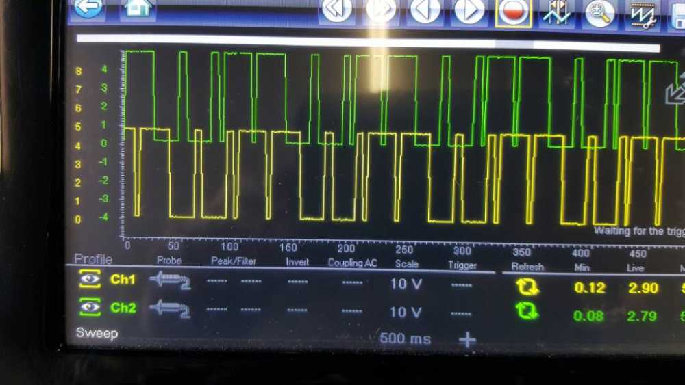

My sister has the same car I'm going to catch up with them later this week and scope there cam to cam correlation I'll post it for anyone who wants a known good . I may or may not have time to pull the valve cover on the problem vehicle in the mean time . But I'll let you all know what I come up with when it's done attached is a pic of the harness on this car

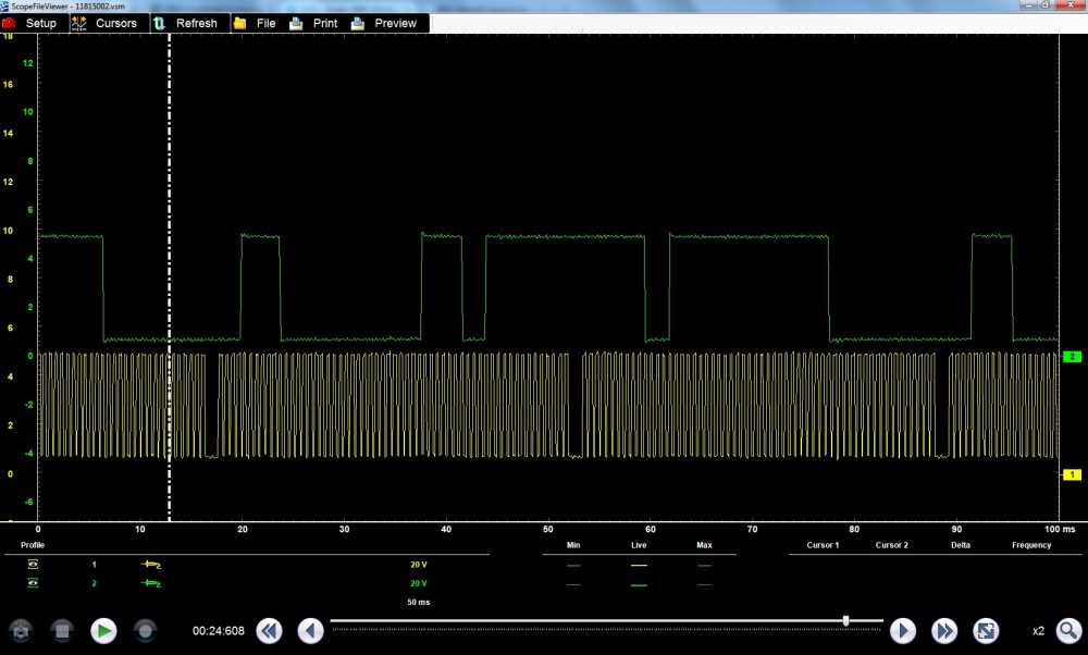

9 years 7 months ago #6758 by SniperDan
Since I have this Equinox at my disposal, I'll grab you a cam to cam waveform. It may or may not work, as this is a GDI engine and I'm sure yours is not, but what the hay. Stand by.
~W. Edwards Deming
9 years 7 months ago #6760 by SniperDan
Here you go. Green trace is the intake camshaft, and the yellow trace is the exhaust. This capture was taken at idle, with BOTH camshaft solenoids disconnected, so the engine computer could not make adjustments to timing.

9 years 7 months ago - 9 years 7 months ago #6806 by SniperDan
I'm glad to have helped! Mine was a gunked up VVT solenoid. Vehicle only had 60,000 miles and was a little late on a few oil changes I suppose!
EDITTTTTTTTTTTTT!!!
I realized I made a HUGEEEEE mistake recommending the diagnostic procedure with the desired vs actual cam stuff. The fault code on my equinox was a P0014, not a P0017.
Upon going back and re-reading, I realized we were dealing with two completely different problems!
Hopefully no one in the future will get confused on this. Again, apologies for misreading brother!
