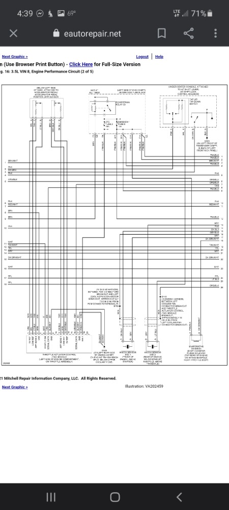

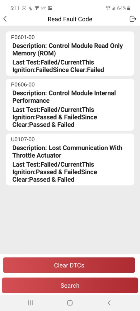

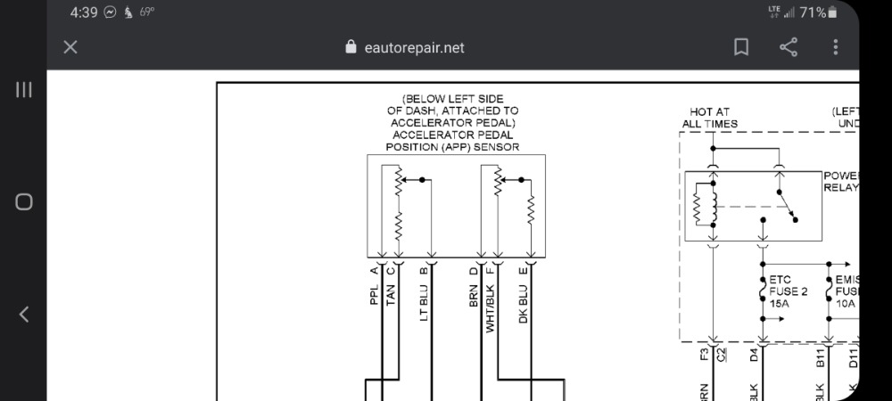

On the diagram I have a 5 volt ref to and from TAC Module and Accelerator pedal sensor. I don't see 5v ref to and from the computer to the TAC, only the high speed data wires. The 5v ref are both around 3v. I have a code for ecm no com to TAC. Powers and grounds for ecm are good. But I have codes for memory and processor error for the ecm. I'm stuck on the 5v ref thing, I don't understand how its only between the TAC and Accelerator Pedal Sensor. At first I had no com to the ecm but I cleaned grounds and I have com now. I also have intermittent no com with power steering module but I can get readings from all sensors when I have com and they agree, have steering torque readings and angle etc. I'll attach a picture of the codes. Any explanation is greatly appreciated!!

I had to look up a 2005 G6, 2004 doesn't list aG6 in Shop Key.
It looks as if the TAC supplies the 5v ref for both legs of the accelerator pedal sensors. If you have only 3v coming out of the tan and white and black wires at the throttle body, then you need to verify power and ground at the throttle body.
Pin 8 and 17 are grounded at g105 (under coolant hose on transmission stud).
Key on power is supplied to the pink and black wire from ETC fuse 2 via power train relay 33 (both in under hood fuse box).
