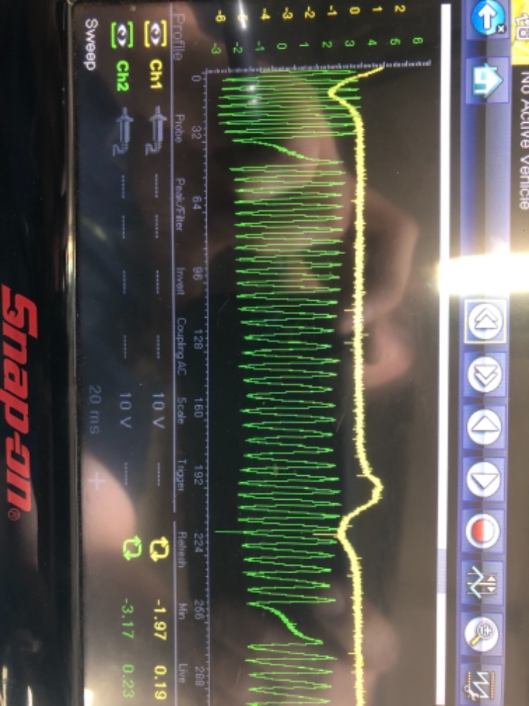

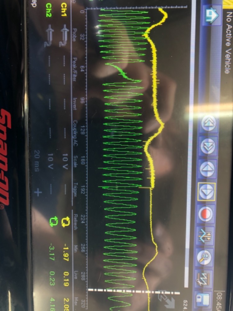

Need a cam crank relationship waveform for 2006 Scion tC

Crank no start sounds like a timing issue.

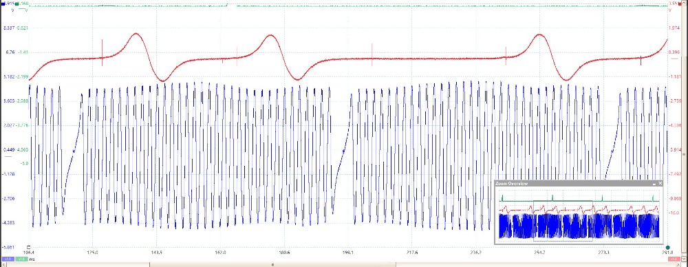

Courtesy of the L1 Automotive Training waveform library:
www.l1training.com/waveform-library/
They didn't have an '06 tC, but they did have an '06 Rav4, which is likely the same 2.4L?
Timing is too similar to be coincidence. But, if I remember right, only the intake cam is monitored on these engines. Exhaust could still be out.

Looks like I’m missing something. I only have one tooth on the cam that’s 5 teeth before the sync notch on the crank
