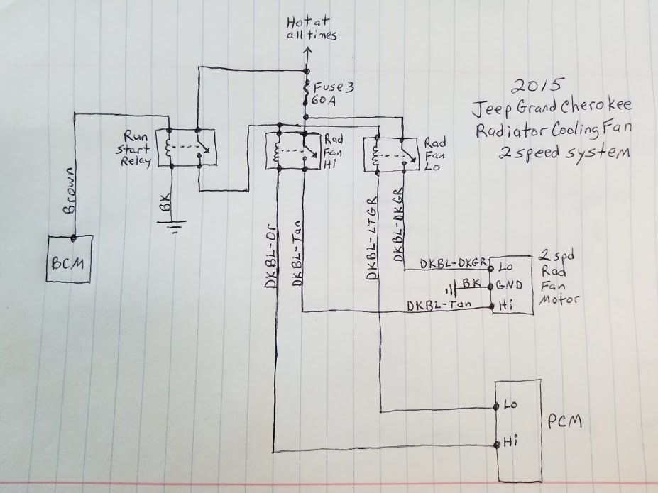

Hi all,
My 2015 Jeep Grand Cherokee SRT was involved in a front end accident. No airbags were deployed. The one issue I’m having is the radiator fan doesn’t turn and my scanner shows P0480 (Cooling fan 1 control Circuit/open. I got three fans the one involved in the accident, after market and one that came from a Dodge Durango. None of them worked. The fan comes with positive, negative and another very small wire. Here’s what we did so far... we check the fuses Rad fan, high speed and low speed relays. I am pretty sure the plugs have power from multiple test I have done. We tried to jump the radiator fan-none worked. We actually replaced the water pump since the pulley was wobbling a a bit. I tried to reset the codes, but it doesn’t erase. Lastly I did check continuity on the small wire and the fuse and not sure if it’s working as I should. When I start the car it beeps for about a second. Surely it’s going to a system check? I figure the last thing it could be is a bad ECU since I can’t even clear the code as well.
Anything help
Anything help

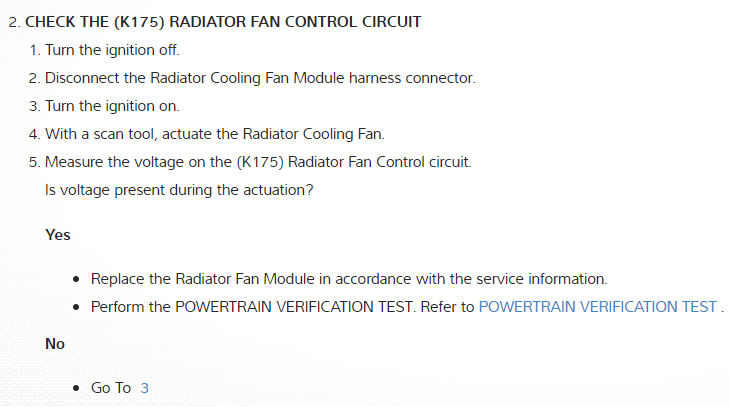

I'd start with load testing the two large cables at the fan connector. Use a headlight or other similar heavy load. One wire to red, the other to black. Does the bulb light brightly? If yes, I'd consider those circuits good. If not, find out if the power or ground is missing.
The small wire is a PWM signal from the PCM directly based on commanded fan speed. I found this step in the P0480 flow chart. See attached.
Check for voltage on the small wire as directed. I don't know what you're going to see? :silly: But the flow chart seems to be happy with just about any. Let us know what you find and we'll go further.

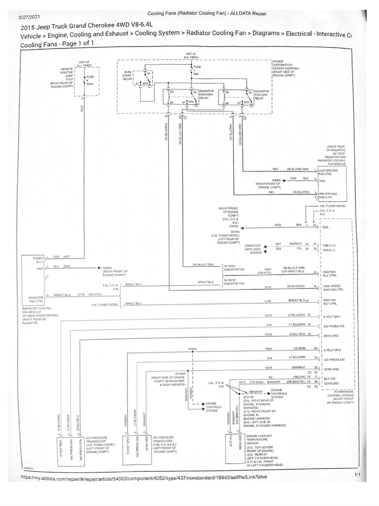

What voltage do you have at the computer? Connector C1, pin 30.
If you have higher voltage at the computer, but only 40mV at the fan connector, then you have a wire problem. It could be a broken wire or high resistance somewhere along the wire.
If you have 40 mV at the computer then check for a short to ground. Unplug the computer and unplug the fan to isolate this wire and check for continuity to battery negative. The only good reading is OL.

I'm sorry Jeffrey, I'm still not clear. Does one of the big wires light a test light connected to B-? Does the other big wire light a test light connected to B+? If so, we'll consider those circuits good enough for now.
The small wire will only show voltage during commanded fan activation, per the flow chart. The PCM may be doing some kind of circuit check, as you noted, and shutting the circuit off in response. Does your scan tool have bidirectional capability?

I had someone check it out and they say it’s the Radiator Fan Cooling module. I did check the post and it actually didn’t light up immediately. After messing around with it did finally light. Not sure if that could play a part. I’ll take a better look to see if I can find the module, because I didn’t think it had a separate module. “Right rear of radiator) (w/350w)” How would I know if it’s a 350w, it doesn’t say it any where on the old fan.
