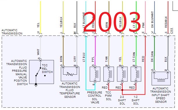

No offense meant here, but are you sure P1810 is the code you're getting? :huh: Because I can't find it in service info.
P1811 Maximum Adapt/Long Shift, however, is a very common code for the transmission in your Venture. It sets when there's a shift time longer than .65 seconds, and the PCM has maxed out the adaptations to shorten it. Two long shifts in one trip generates the P1811.

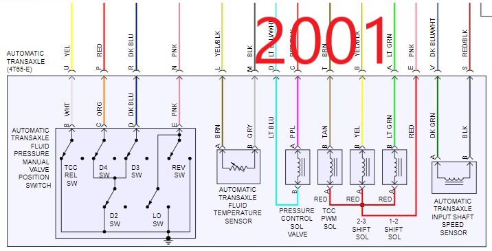

IIRC this van has a PCM from an earlier model year in it. Just checked and P1810 is a valid code for the '01 MY. Don't have time to compare '01 and '03 transmission wiring diagrams right now.No offense meant here, but are you sure P1810 is the code you're getting? :huh: Because I can't find it in service info.
5 years 5 months ago - 5 years 5 months ago #49215
Replied by Tyler on topic P1810 but Fast Idle
Bus driver Matt T takes me to school again. :blush: :lol: You're right, it is a code for an '01.
I wonder if the code is the result of the '01 PCM looking for inputs that don't exist on the '03 transmission? Because the '01 diagram shows pressure switches, but the '03 doesn't.

Pretty sure you've confirmed what I suspected. P1810 is a pressure switch plausibility code............
Replied by Matt T on topic P1810 but Fast Idle
Was just something I remembered from the end of the last thread on this van. It was setting a pre '03 code after the PCM swap.Bus driver Matt T takes me to school again. :blush: :lol: You're right, it is a code for an '01.

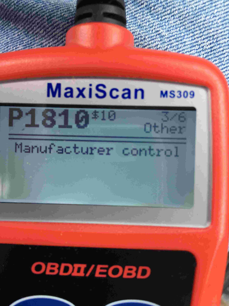

Attached is the error and you are correct that the computer was the problem. HOWEVER, I not being a mechanic did not suspect there to be a difference in transmission because both the 2001 computer VIN and my Van VIN...when I research specs, says the transmission is the same. Thus I figured my van might be hard shifting and sometimes slipping because maybe the 2001 computer I used for replacement was looking for a secondary air pump that is not present on my 2003 Venture. THERE WAS A VERY FAST IDLE UNTIL RUNNING TEMPERATURE WAS ACHIEVED. However, you may be correct and likely are, not only because of your experience, but because my van has a replacement transmission in it that I believe came from a 2005 Pontiac Montana back in 2016.
I did not see this forum entry until after I decided to risk $25 on a PCM from a 2005 Pontiac Montana. I put it in yesterday and it learned my key right off the bat and the van runs like a champ. IN FACT, I believe my transmission likes this 2005 Montana PCM better than it liked my original PCM for my 2003 Venture. (Sadly the mechanic that did the replacement job back in 2016 is no longer with us since about 1 month after he replaced the transmission.) This van runs great right now with no codes (EDIT...maybe not true..see reply after this entry). I can run it in drive an no hard shifting, no slipping. I can only hope that I didn't overstress things like my fuel pump and transmission while trying to get the van running with the original computer. My fans run properly too. They were not running properly with the original PCM and the 2001 PCM. Until I put this latest PCM in my van, my coolant fans would not run when the AC was turned on. I still think there might be an issue here. They are not spinning very fast. Maybe my high speed fan control or relay is a problem, I'm not sure but both fans are running yet the tempurature drifts pretty high in idle. This may be the only issue I have to resolve along with passenger side air bag and ABS but I am not really worried about those.
Attached is the P1810 I was getting. It says 3/6 because the other two errors were for the secondary air pump that did not exist in my van and my scanner repeated all 3 errors twice. NOT THAT IT MATTERS AT THIS POINT but when I search my vin and the vin of the 2001 PCM for vehicle specs they both show the exact same transmission. I have not searched the vin for the 2005 Pontiac I took this latest PCM from.
Replied by Sopey52 on topic P1810 but Fast Idle
