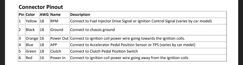

 Need to find out pin outs for my 2008 Mitsubishi Lancer GTS manual 2.0L
would love a diagram or color codes for each of these
