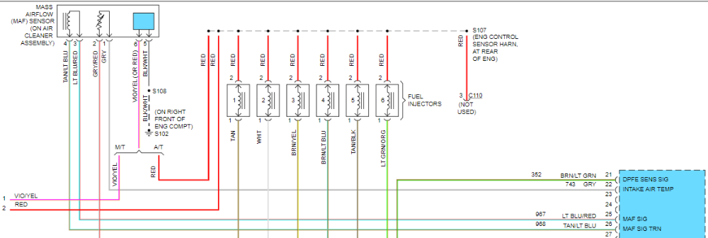

5 years 5 months ago #49336 by Tyler
Replied by Tyler on topic 05 Mustang with a few codes
I've attached the wiring diagram for your MAF. We need to be clear on this - you're shorting B+ to the red wire, pin #6 of the MAF connector?
When you say Fail Safe, what symptoms are you talking about, specifically? Power loss, rough running, stalling? Not trying to scrutinize you, but it really does matter in this case. :)
If the engine never stalls or becomes a crank/no start, then I'd strongly suspect broken/corroded wire in the red wire between pin 6 at the MAF and S107. That'd explain the loss of power to the MAF while still having the engine running (since S107 is the power feed for the fuel injectors).

5 years 5 months ago #49347 by Matt T
Replied by Matt T on topic 05 Mustang with a few codes
S107 is a splice. It's the dotted line top center of the wiring diagram with all the red wires going to it.
Is the vehicle automatic or stick shift? You mention the MAF feed being the correct color for a stick shift and those don't appear to use S107 for MAF power.

I just realised what the M/T and A/T on the schematic stood for !! That makes more sense now

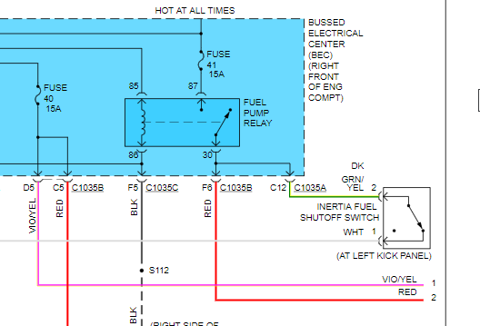

5 years 5 months ago - 5 years 5 months ago #49360 by Tyler
Oops, I didn't ask if this was a manual or not. :blush: My mistake!
Since it's a manual, we're looking in a different area now. The yellow/violet actually comes from pin D5 of C1035B in the underhood fuse box. That pin is fed by fuse #40, which also feeds the ignition coil power on pin C5 of the same connector.
The good news is that your list of suspects is pretty short. :cheer: A connection problem at C1035B, or an open in the yellow/violet wire between the fuse box and the MAF.
At this point, it's up to you to decide how deep you want to go. You can remove your jumper and follow the yellow/violet from the MAF all the way to the fuse box and test for voltage as you go. When you find solid 12V, you know you've gone past the open/high resistance. I mention C1035B because it's also possible that the pin in the fuse box itself is corroded or damaged. Keep your eyes open.
Or, you can run a new wire from fuse #40/the red wire at the ignition coil. That'll maintain the ability of the PCM Power Relay to shut off power when needed. I don't love running new wires, but some times you just need the car to work. :silly: Use grommets, tape, and conduit as needed to make sure the new wire doesn't ground out anywhere. Something like this might make the job easier:

5 years 4 months ago #49380 by BluStang05
Replied by BluStang05 on topic 05 Mustang with a few codes
Well,. I'm trying not to jinx this but I think it's fixed!!
I opened up to check the fuse to make sure it was good and when I pulled it there was some corrosion on on of the legs.  I cleaned it up and stuck it back in and the fuse felt a little sloppy.  So I tried to get something down in the slot to bend in a bit but that was not working so I then decided to bend the legs out a tiny bit in opposite directions and plugged it back in.  I started the car and it fired off I cleared all the codes and went for a lil bit of a drive and have not had any issues!  I'm gonna scan the codes in a day or 2 and see if anything comes up but I'm feeling good so far
