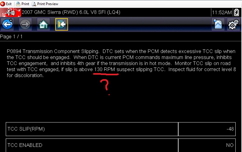

First is an '07 Sierra that came with a slippage code. Watched the TCC go into full lockup and never saw the slip PID go anywhere near zero. :lol: 200K+ miles on it, went with a rebuilt transmission. Worked perfectly afterwards.

Ah yeah, seen those, pretty much death codes for the trans. :lol: This '07 Sierra was showing me a P0894 "Transmission Component Slipping". Gotta love the straightforward code descriptions!
TCC slippage is one of the worst things to deal with. Especially if the rest of the transmission is in good working order. If you're light cursing and the TCC is 100% applied then you want to see less than 10 RPM on a good vehicle.
I think your rule of 10 RPM is right on. I'm glad you mentioned that, 'cause the Troubleshooter for this code had this to say:
130 RPM? That's pretty generous! :ohmy: I've diagnosed many TCC shudders that fell well below that number, and still had internal issues.

One of my favorite hobbies is giving my Snapon rep a hard time. I might just screen cap that and show it to him. Forget about the fact that 130 RPM is HUGE but it says, "If TCC slip is above X RPM then suspect a slipping TCC." Really?? Ya don't say!! :lol: That PID is called TCC Slip! It measures slip... so of course if you have any RPM then the TCC is slipping! :P Of course it doesn't tell you what's CAUSING the slippage...
But ya, less than 10 is considered good on a light cruise, flat road, low engine load. A new trans should have less than 5. If the rest of the tranny is junk then that's easy. But if the rest of the tranny is great then it's hard to decide where to go. If you try saving money just changing a component then you could easily end up spending more by the time it actually gets fixed. Not to mention a customer is going to be hesitant to authorize much. As far as they're concerned the vehicle still drives fine. They don't notice the lack of lockup and they certainly don't care about it enough to start throwing thousands at the vehicle. Some older trannies will let you have all gears with a malfunctioning lockup.
