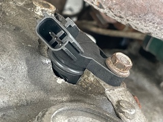

I'm working on a '07 Nissian Quest 3.5L I'm diagnosing a intermittent no start, everything reads as should please look at picture to condemn the reason, a portion of metal missing off trans housing ?

imgur.com/a/Qzl8cdH
www.nicoclub.com/service-manual?fsm=Quest%2F2007%2Fec.pdf
page 387
You must see the crank signal on a scope first, and if that's wrong, then worry about that cracked trans housing. It should go from 12 volts to 0 volts in amplitude.
