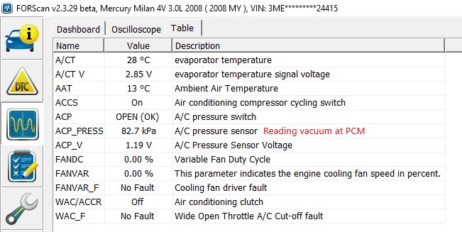

5 years 4 months ago - 5 years 4 months ago #49803 by Matt T
About the only way I can see both problems sharing a common cause is if no freon is getting into the system. So there might be something going on with your gauge set? Maybe test it on another vehicle.
Below is from an '08 Mercury. Aftermarket AC pressure sensor telling the PCM the system was under vacuum!! This didn't set a code but did stop the compressor from engaging. Should give you an idea of what PIDs to go after if you don't find anything wrong with the gauge set.

5 years 4 months ago #49852 by mkingan
I think that the relay is not being commanded by the PCM for some reason.
5 years 4 months ago #49854 by Chad
If you have a scan tool, you should be able to see if the PCM is receiving a request to engage the Clutch relay. You should, also, be able to see if the request is allowed, or denied.
