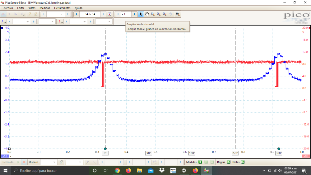

5 years 4 months ago - 5 years 4 months ago #49837 by samuel.barajas
So i ran the pressure transducer test again, this time with the car running, not just cranking, and got this ...(the red trace is the spark trigger for that cylinder)
There seems to be pressure build up in the exhaust stroke, could this be it ?
Also, why do my graphing looks like that ? is it some settings im not choosing properly or is it due to the capabilities of my scope?

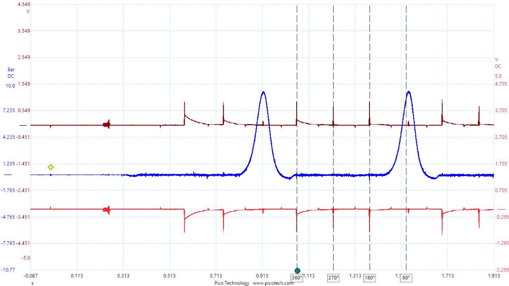

5 years 4 months ago #49840 by Wightscope
I assume you are using a 2204A scope?  There should be no issues with it collecting a much better waveform than that - take a look at "Mechanic Mindset" on youtube for some hints on setting it up and working round it's limitations.
The pressure waveform issue looks to be with your sensor - if you are using a home made sensor on a traditional compression kit have you removed the schraeder valve from the tube ?
For example this is a 2204A with a home made sensor. - extra channel is just an inverted maths channel for the coil.

5 years 4 months ago #49843 by juergen.scholl
It looks like the sampling rate of your very sensor is much too low, hence the chopped waveform. Did you use this sensor on other cars and if so, what was the outcome?

5 years 4 months ago #49850 by samuel.barajas
Right on with 2204a scope, it encourages me to see that it can do WAY better waveforms, i will definitely be checking that channel, i did take the schrader valve off, im using a home made pressure transducer sensor as recommended by this guy

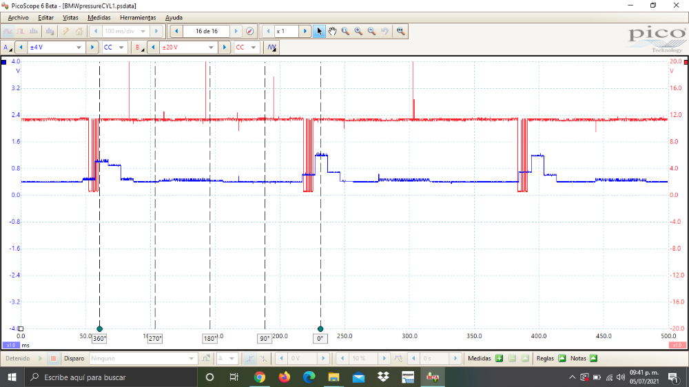

5 years 4 months ago #49853 by samuel.barajas
    I think you might be right with the sampling rate of my sensor, heres the cranking waveform
There doesn´t seem to be any pressure build up, but again this is just cranking, in my running waveform there is something going on that is very consistent with the exhaust stroke, i just dont know if it could be enough to cause this... I  am fairly new with this tools but have already used my current setup to succesfully identify timing issues.

5 years 4 months ago #49867 by juergen.scholl
A cranking waveform will show HIGHER pressure than one of an idling engine will do.
The way your waveforms are they do not have diagnostic value, it is impossible to conclude problems from them regarding the exhaust stroke (or valve opening, sealing etc.).
A lot of the e-bay sensors are not up to the task, even when they specify an update rate of ≤1ms. They don't comply.
