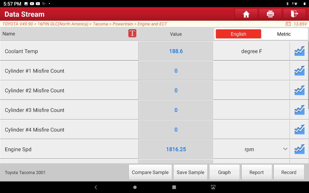

2001 Toyota Tacoma 2.7 high idle
  • gilbert
5 years 3 months ago #49919 by gilbert
2001 Toyota Tacoma 2.7 high idle was created by gilbert
God bless you my brothers and sister.
. Ok I did timing chain and new head after all was done the idle is at 1,800 in park. When in D idles at 900. Here's what I have tried so far,
 I checked for vacuum leaks and found none following a smoke test, I cleaned T/B, IAC and MAF and still no luck. When I disconnect the throttle cable from the throttle body it doesn't affect rpm and maintains at 1800 while in park.  T/B position is at 10.59 at idle and key engine off it's at 12.30 is this normal?
. Thank you for your help.
