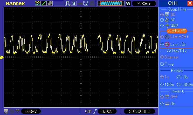

5 years 3 months ago - 5 years 3 months ago #49953 by Nathan1
Hello all,
2018 GMC Acadia 3.6L V6 62,000 miles bought used.  Not long after purchase the check engine light illuminated and I see a P219A which I understand to be a fuel mixture problem on the bank 1 cylinders.  The check engine light will illuminate, and then go out a few drive cycles later but the code is still stored.  I have copied PID freeze frame below.  Car runs and drives great, no noticeable problems with the engine.  Transmission shifts sort of weird but that's a separate issue I am investigating.
Things I have done:
-Monitor live 02 readings.  Bank 1 upstream is a sort of dirty wave form compared with bank 2 which shows a nice quasi sine wave.  Not sure if that's a problem.   Bank 1 and 2 downstream seem to keep a fairly constant .745ish at idle.
-I checked electrical connections and can not find anything out of place or burned, loose, corroded.
-I checked the Bank 1 upstream heater element and it reads 6.3 ohms so that's fine I guess.
-I removed the air filter and vacuumed out the dirty side of box.  Element was a bit dirty but nothing crazy.
-I checked the oil and I do not detect an overt fuel smell, smells like oil when I do an oil change.  I know bad injector can be a cause of P219A.
I am hoping to fix this myself if possible.  Thanks all.

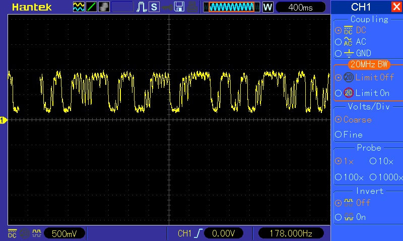

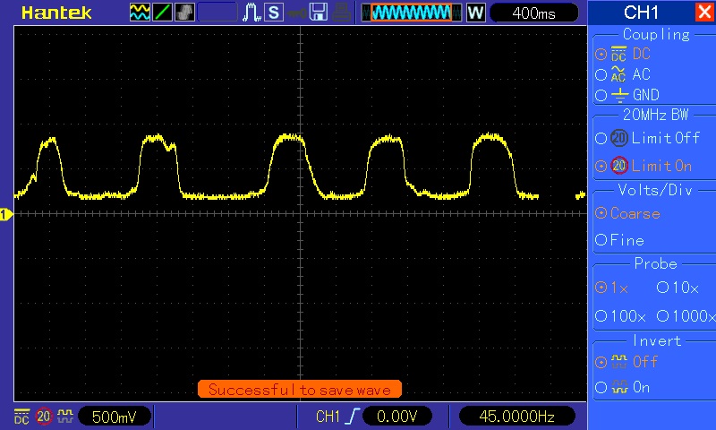

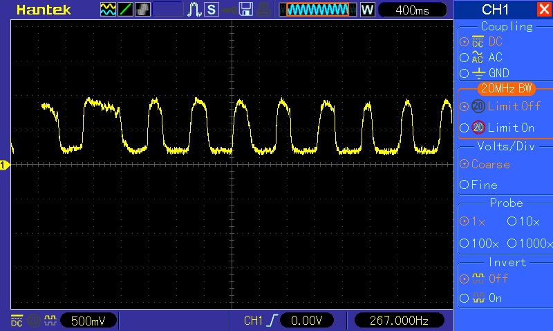

Since I have the probes now I decided to capture the waveforms on both upstream O2 sensors on my DSO.   I probed the signal and ground directly from the connector.  I am really interested in your thoughts on these, they are quite different form bank to bank.  I am going to swap them side to side this afternoon.
Bank 1 idle:
Bank 2 idle:
Bank 1 2000RPM:
Bank 2 2000RPM:

I swapped o2 upstream o2 sensors side to side and the problem (dirty wave forms as above) did not follow the o2 sensor.  I figured this would be the case.  I also removed the evap line from the purge valve and found that it is not stuck open.
Other relevant information (I think):
1- Long term fuel trims are biased negative so that rules out a vacuum leak right?
2- I do not perceive an exhaust leak, no ticking or puffing that I can see/hear. Could a super tiny exhaust leak cause this problem?  Its sort of difficult to thoroughly examine the bank 1 side since its against the firewall.
3- I get no misfire codes or anything related to the coils or spark plugs.
4- Maybe relevant, the fuel economy estimate on the Acadia is about 1-2MPG high.
5- Again, it runs and drives perfectly fine.
I am going to clean the MAF sensor (thinking of the negative biased LTFT on both sides) but I do not have confidence that this will have much effect.  I think I will also remove and inspect the spark plugs and coils on that side if the MAF cleaning does not bear fruit.
I want to rule out everything before I dive into replacing the injectors.  What have I missed?  Are there any other diagnostics I can do that would help pinpoint this?

Before swapping the front O2 sensors the bank 2 sensor showed slower response time. I suppose he did the same when placed into bank 1?
Do you have a chance to borescope the intake/cylinder for carbon built up at this milage?
