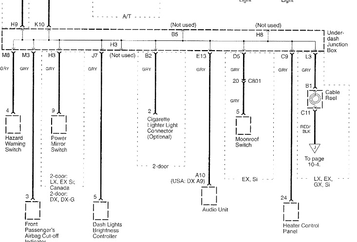

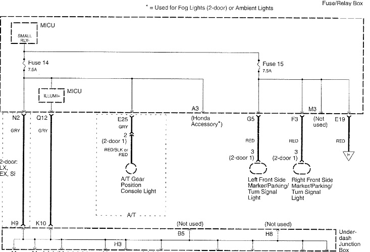

Which fuse were you looking at, specifically? It's tough to see on the wiring diagrams which one is the back up circuit. I had a glance at the power distribution, and I see a fuse #14 in the under dash box that seems to cover some of the systems you listed:
Does your draw go away when you pull this fuse?
When you noted using a test light on the positive cable, do you mean that you put the light in series between the battery post and the cable end?
