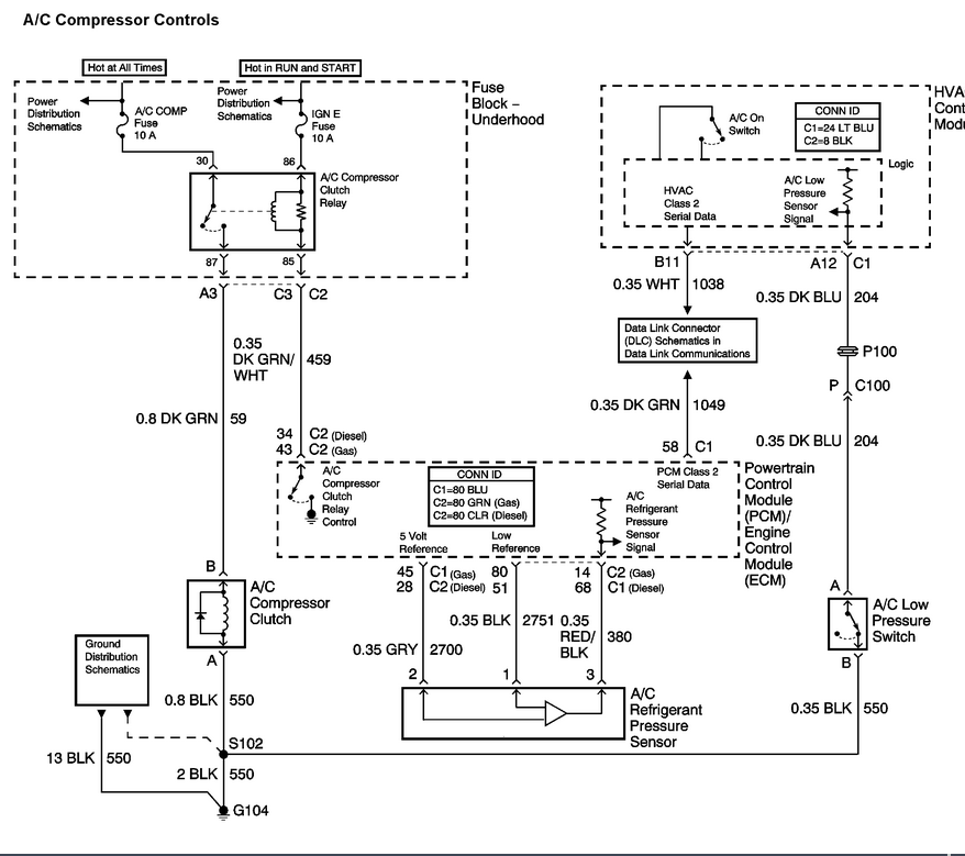

Check the voltages on the Refrigerant Pressure Sensor. You should have 5 volts on the Gray wire, and 0 volts on the Black wire. The Red/Black wire is the signal wire. Low voltage is low pressure. High voltage (5 volts) is high pressure.
A/C Refrigerant Pressure Sensor
The A/C refrigerant pressure sensor is a 3-wire piezoelectric pressure transducer . A 5-volt reference, low reference, and signal circuits enable the sensor to operate. The A/C pressure signal can be between 0-5 volts. When the A/C refrigerant pressure is low, the signal value is near 0 volts. When the A/C refrigerant pressure is high, the signal value is near 5 volts. The PCM converts the voltage signal to a pressure value.
The A/C refrigerant pressure sensor protects the A/C system from operating when an excessively high pressure condition exists. The PCM disables the compressor clutch if the A/C pressure is more than 2957 kPa (429 psi). The clutch will be enabled after the pressure decreases to less than 1578 kPa (229 psi).
Also, Check for a ground, that comes from the Low Pressure switch, on pin A12 (DK BLU) of the HVAC Control Module.
A/C Low Pressure Switch
The A/C low pressure switch protects the A/C system from a low pressure condition that could damage the A/C compressor or cause evaporator icing. The HVAC control module applies 12 volts to the A/C low pressure switch signal circuit. The switch will open when the A/C low side pressure reaches 124 kPa (18 psi). This prevents the A/C compressor from operating. The switch will then close when A/C low pressure side reaches 275 kPa (40 psi). This enables the A/C compressor to turn back ON.

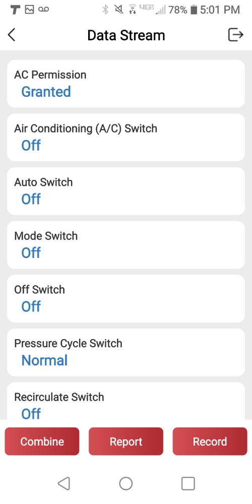

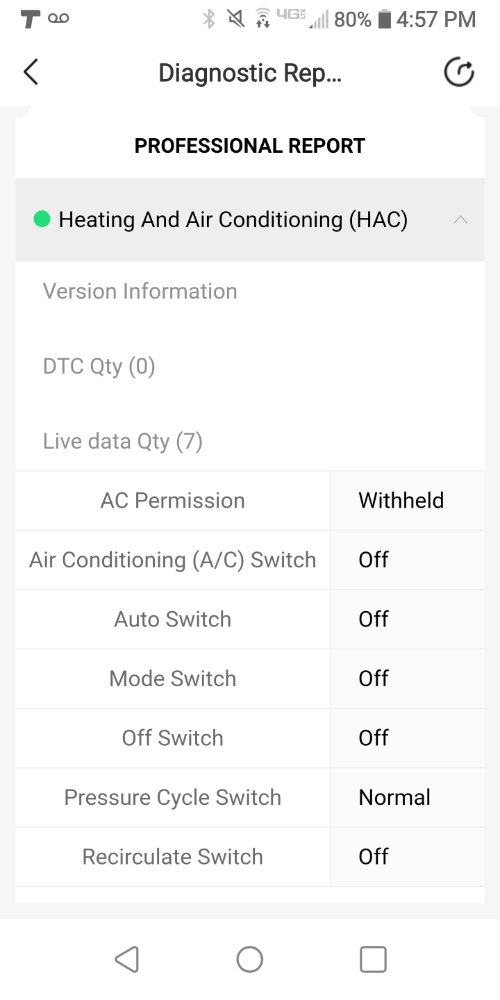

First screen shot is me pushing the snow flake ac botton and ac get whithheld and ac clutch dont kick on and second screen shot is if i turn off ac snow flake ac pump will kick on ac clutch i changed out 3 wire ac pressure sensor and it does the same so all sensors are now new but i bellive ac system has a leak somewhere cause if i command everthing on now ac aint blowing as cold as it did yesterday so im guessing thats why snow flake ac is being whithheld cause of a leak if i start all over and pull a vacume back down to 30 and then turn it off and let it sit and it moves back up should tell if there is a leak right ?then run dye back thru it to find where the leak is at

Make sure your vent setting is not showing defrost on the display. It will not let ac run with it in that position. This applies to auto ac as I have similar model
