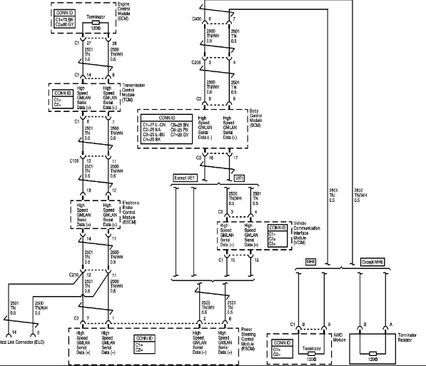

I looked at the iATN TechHelp you linked, it ended in BCM replacement. BUT, they also had other stuff going on, like door locks cycling, lights going out, traction control indicator illuminating, like that. That Chevy workshop manuals TSB you found might be on the right track, but only if you're actually losing power steering at the same time. :unsure:
Here's a quick glance at the network topology:
At first glance, I don't suspect a wiring issue at all. If there were some kind of open between the BCM and PSCM, then you'd be getting loss-of-com codes in other modules further down the line (ECM, EBCM, ect.). Same for a short.

I put a multimeter across pins 6 & 14 on the DLC and wiggled the connector at each point starting at the power steering module, then I'd disconnect the plug and make sure the resistance rose to 120Ω, I worked my way from module to module to each end of the network, ending at the EOL resistor near the fuel tank and then at the PCM which serves as the EOL resistor on the opposite end, the ABS module plug moved the DMM some so I disconnected it and sprayed contact cleaner in the plug and reconnected it. The passenger airbag still won't come on and driving it 20 miles produced yet another friggin P0300 code.

Tyler wrote: Any dash lights, or power steering issues when this code set? Just wondering if there's any other symptoms associated with the code.
