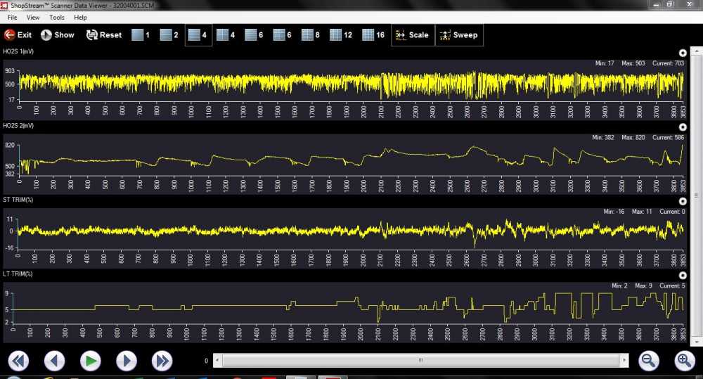

Here is a shot of part of the data I collected, the upstream O2 is on top, the waveform does not look right to me, the frequency is too high, I am used to seeing about a one second sweep but this thing is jumping all over the place and it doesn't go from 100 to 800 ish, often it runs in a tight band of a few mV.
I have the whole file of course, it is 4000 frames, or 71kB if anyone is interested in seeing it.

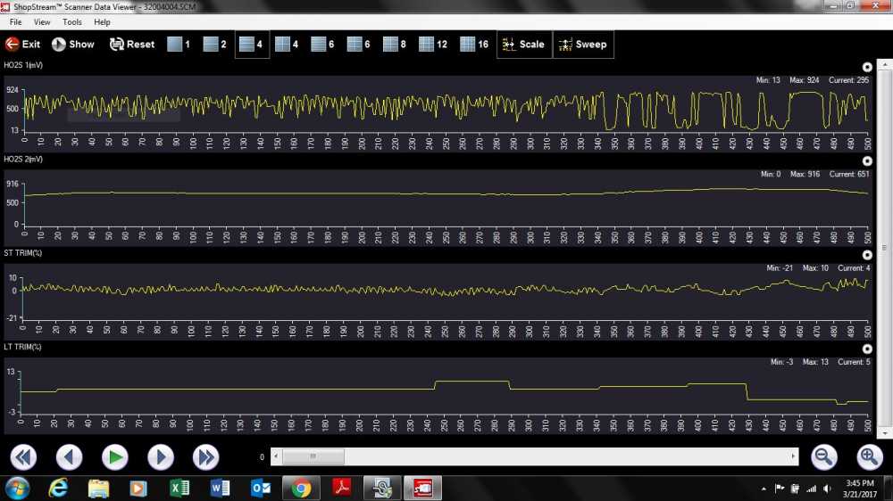

Zoomed all the way out gives a better perspective on it... this is different file, it is about 20 minutes earlier than the first one...

9 years 7 months ago #7685 by Ben
Was this taken at idle or driving or part revving? It's not uncommon to see 02s readings lag with missfires
9 years 7 months ago #7686 by Ben
Also is the engine fully warmed up when this is taken?

9 years 7 months ago #7720 by Gary B
Ben wrote: Was this taken at idle or driving or part revving? It's not uncommon to see 02s readings lag with missfires
Hi Ben,
This was on the Interstate at a pretty steady 65mph and the engine was fully warmed up. One capture was started about 20 minutes into the trip the other was about started about 5 minutes in.
9 years 7 months ago #7724 by Ben
It doesn't look horrible to me for driving was you experiencing any misfires during your drive?

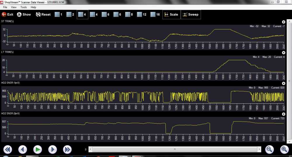

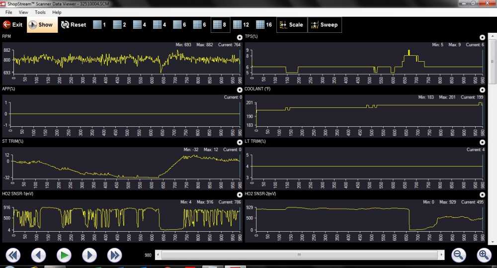

I don't remember either, here is a screenshot of normal, then I start adding propane around frame 700 to about 1200, then pull a vacuum leak around 1500 to 1600.
here is another with a few more pids
I saw Tyler or Noah use a PID sharing service but I don't know how to do that yet, I can email the full files if you want them. But, what I see is the STFT reacts to both the propane and the vacuum but the LTFT never reacts to the propane. I'm going to do another test with propane and vacuum and watch the misfires.

Why doesn't the LTFT ever adjust during the propane test? I see it start adjust almost immediately for the vacuum leak, once the STFT hits 22 the LTFT starts adjusting but during the propane test it never does even though the STFT seems to max out at 32.

9 years 7 months ago #7915 by Tyler
Gary B wrote: Thanks Tyler,
Propane Test
Propane and Vacuum Leak Test
Gary
Nice ScanShare links. B) I see what you mean... Not sure? The 'FUEL TRIM LEARN' PID is enabled in both cases. :huh:
I'm speculating that it's a programmed behavior, as they may not want the PCM to adapt too quickly to a false rich condition. Then you end up with stalling, poor acceleration, high cylinder temps, ect. I wonder what would have happened if you'd have kept the propane on it longer? :huh:

Tyler wrote: Nice ScanShare links. B) I see what you mean... Not sure? The 'FUEL TRIM LEARN' PID is enabled in both cases. :huh:
Thanks, the credit goes to you though for letting me know about the scan share site.
I left the propane on long enough that the tips (I used both torches that I have) frosted up and the bottle pressure started dropping, you can kinda see the STFT start to rise slowly so I shut them off. I will try again and time how long that takes and also see how quickly the LTFT takes to react to the vacuum leak. Those tests that I show here were actually the third and fourth tests so the bottles had lots of time to get cold.
