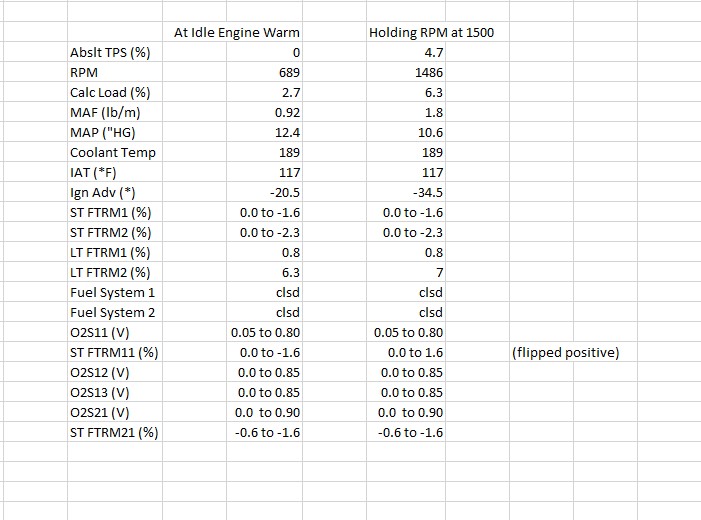

5 years 3 months ago - 5 years 3 months ago #50373 by stylingpat
Replied by stylingpat on topic What are the correct fuel system specs?
And here is a look at ol betsy, 380k miles still sounds like a sewing machine
How does she look?

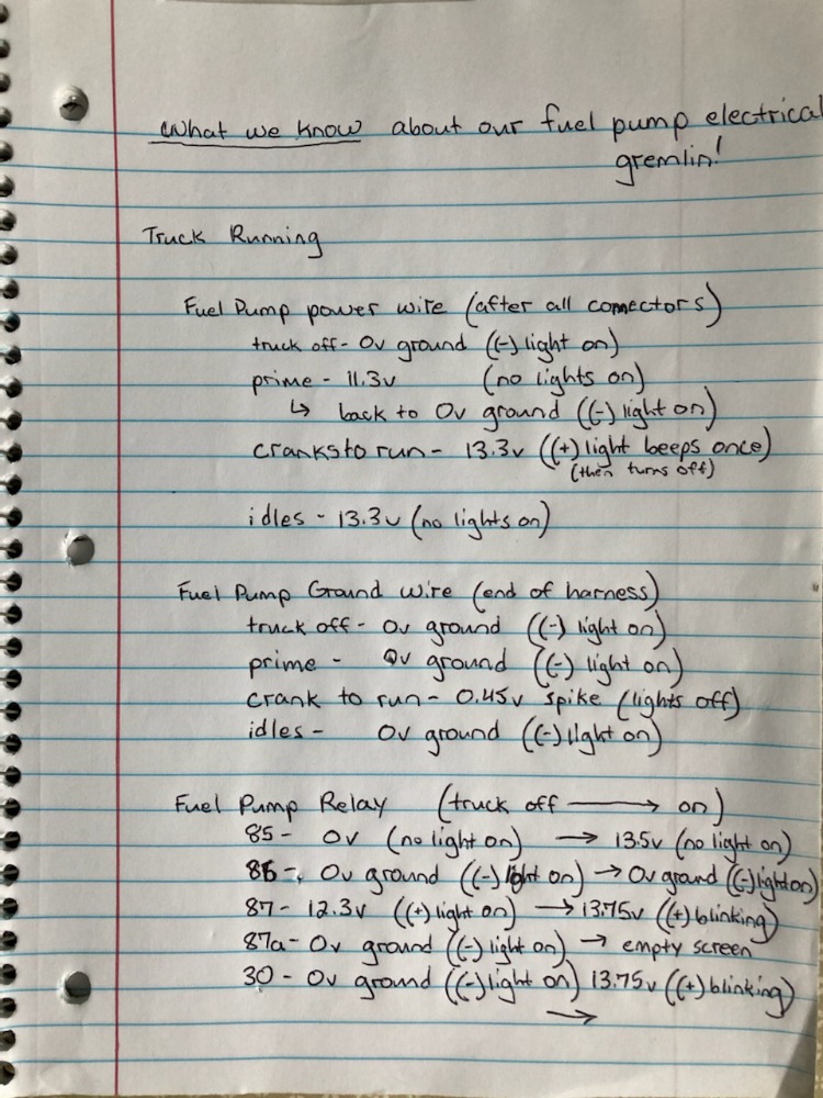

5 years 3 months ago - 5 years 3 months ago #50414 by stylingpat
Ok, so here is my fuel pump electrical system data capture!
Also before you read through the data, understand I am using a Power Probe 4, so hence my inclusion of the (+) and (-) lights.
Last edit: 5 years 3 months ago by stylingpat.
5 years 3 months ago #50415 by Chad
Replied by Chad on topic What are the correct fuel system specs?
Is there a difference between checking the ground wire and checking the ground bolt?
Yes. If the ground WIRE is bad, you will see a good ground at the bolt, but elevated voltage, on the ground wire, at the pump. Suppose there is corrosion in the wire, half way between the bolt and the pump. On the bolt side of the corrosion, the ground is still good. But, on the pump side of the corrosion, you may read elevated voltage. The more corrosion/resistance you have, the higher the voltage will be, on the pump side.
Check the ground as close to the pump as you can.

5 years 3 months ago #50417 by stylingpat
Yep, that's as close as I could get on the ground wire.
  • stylingpat
  • stylingpat's Avatar Topic Author
5 years 3 months ago #50418 by stylingpat
What would happen over time at the two images I shown with all my data, if the connection at pin 86 was "loose"? How would that effect the system over time and change the data above, eventually killing the pump motor in 6 months?
5 years 3 months ago - 5 years 3 months ago #50419 by jreardon
Replied by jreardon on topic What are the correct fuel system specs?
86 is on the control side so if only pin 86 was loose, then there's not enough magnetic field strength to close the load side contacts and there would simply be no power to the pump until maybe the oil pressure switch kicks in.
