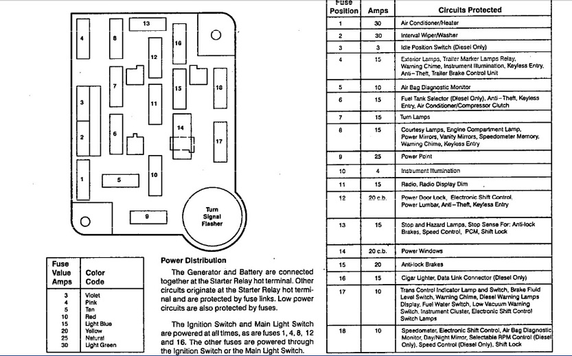

Ok / I ran all the grounds / backprobed all the grounds at the PCM WITH TEST LIGHT on battery posotive . all GROUNDS are present but still HAVE NO GROUNDS AT O2 SENSORS OR SOLENOIDS. IAC,MAF IAT DPFE CRK SENSORS ALL IGNITION SYSTEM MAIN PCM DIODE PCM FUSES RELAYS ALL POWER UP FINE.. I also have a direct short in fuse 16 in the underdash FUSEBOX can you help me with the color wire and any connections so i can trace this down im not sure if this has anything to do with the grounds or not this thing is becoming a nightmare LOL
9 years 7 months ago #7465 by Tyler
Replied by Tyler on topic 1996 Ford F 150 4.9 L6
toadyboy1957 wrote: Ok / I ran all the grounds / backprobed all the grounds at the PCM WITH TEST LIGHT on battery posotive . all GROUNDS are present but still HAVE NO GROUNDS AT O2 SENSORS OR SOLENOIDS. IAC,MAF IAT DPFE CRK SENSORS ALL IGNITION SYSTEM MAIN PCM DIODE PCM FUSES RELAYS ALL POWER UP FINE.. I also have a direct short in fuse 16 in the underdash FUSEBOX can you help me with the color wire and any connections so i can trace this down im not sure if this has anything to do with the grounds or not this thing is becoming a nightmare LOL

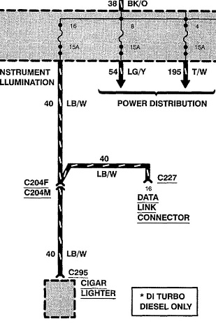

Fuse 16? Shorted, as in it pops a fuse as soon as it's installed? Lemme grab the I/P fuse box diagram.
For the record, I hate how the OE Ford diagrams combine underhood and underdash fuse boxes in the same diagram at times. :lol: Finally found fuse 16:
Not related to your other issues, unfortunately. :( If you wanted to chase this short, I'd probably start with unplugging the cigar lighter and recheck for the short. If that didn't work, then you can follow the light blue/white wire for a short to ground.

even tho the cigar lighter is unplugged and isolated it still pops fuses soon as i install a new 1
9 years 7 months ago #7476 by Tyler
toadyboy1957 wrote: even tho the cigar lighter is unplugged and isolated it still pops fuses soon as i install a new 1
Ah crap, I'm sorry man, that was the easy test first. :( You're down to a direct short now. My go-to test for this kind of thing is to leave the cigar lighter disconnected, and use a test light connected to B+ on the light blue/white wire at the lighter connector. Trace the harness, wiggling carefully as you go, and keep an eye on the test light. When you move the short off of ground, the test light will flicker/go out.

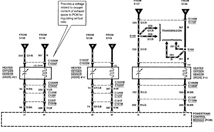

These get a ground inside the PCM:
It's worth noting here that, without the engine running, the PCM may not ground the O2 heaters. It may only ground the heaters once the engine is running.
Does the IAC have a ground when cranking? That'd tell us the PCM has the capability of controlling at least one of it's outputs.

the LB/O GOING INTO THE PCM is the dead wIre so i ran the GROUND from where that LB/O was supposed to be / left the LB/O COMPLETELY DISCONNECTED AND TAPED UNSIDE THE BOTTOM OF THE FUSEBLOCK GROUNDED THE RELAY AND IT NOW RUNS LIKE A SCALDED DOG LOL neither o2 sensor works heater circuits are good and have no grounds to any of the 3 soolenoids on the back right side of the valve cover
