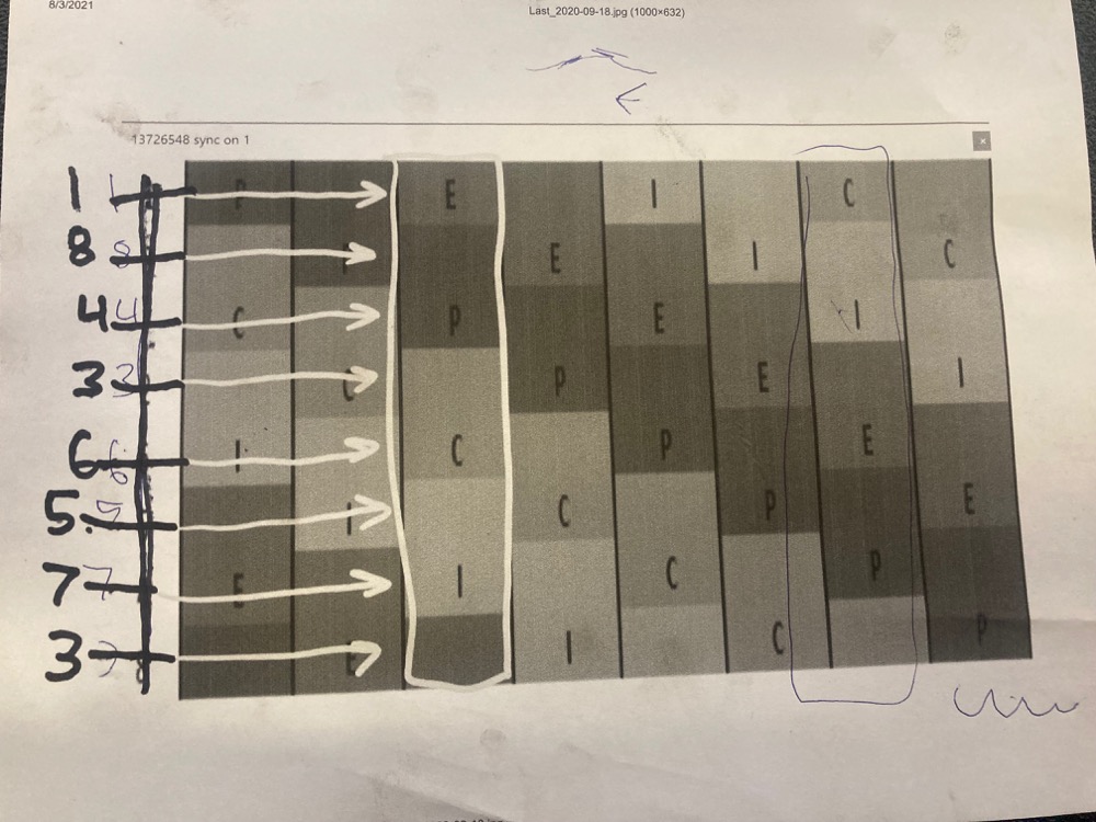

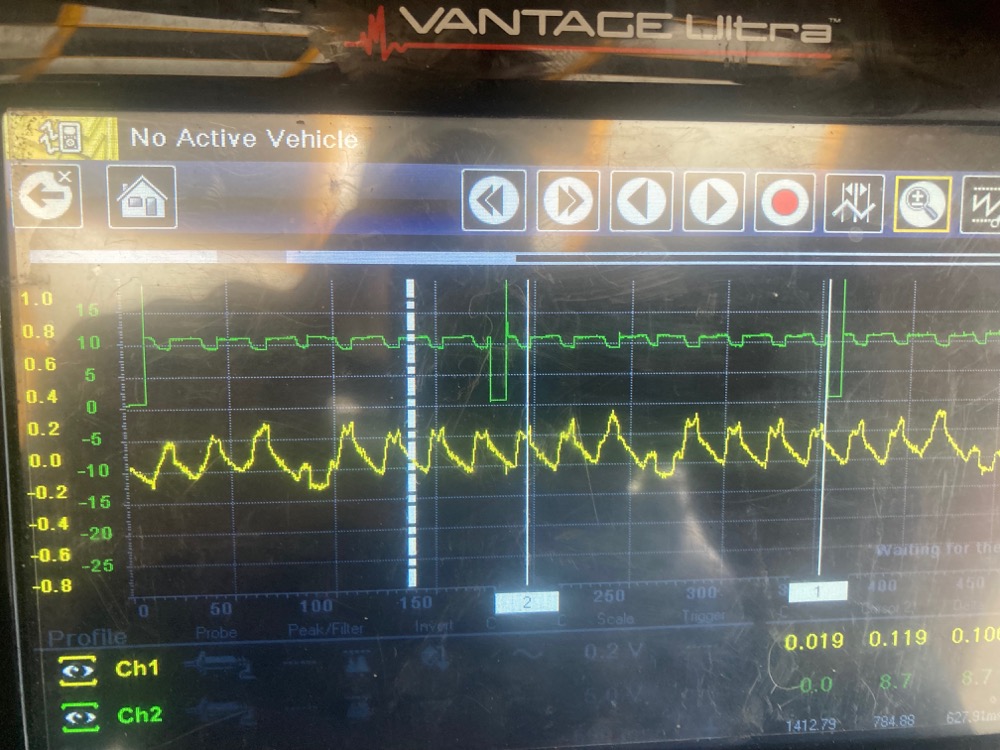

Working on a 2004 dodge 1500 5.7. Customer noticed that the truck had a bad misfire and so they replaced coils, spark plugs and injectors. Still missing. Brought it into the shop had a ton of codes so I saved and cleared them all. Sounded like it was running on only 4 cylinders. Did a relative compression test. Sure enough: dead hole. I also took an intake pulse waveform synced off the injector the same with the RC waveform. (I wasn't sure how else to do it on a Waste Spark system). Found out it was cylinder #4, leakdown test showed the exhaust valve and I noticed a broken valve spring. All that to ask, I want to know what I can learn from my intake pulse waveform.

Got it as a PDF

Is that intake cranking or running? purchased or homemade pulse sensor? If homemade what size disc? I don't see anything very usable in that waveform but I don't have as much experience with the pulse sensor as some of the other eagle eyes here! I did experiment with different size disc's and I can tell you a 25mm disc didn't make a usable waveform I then jumped to a 48mm disc and it was everything you could ask for in a pulse sensor although it sounds horrible with full engine vacuum.... but the waveform is beautiful! Lastly I doubt you'd see much from an exhaust valve in an intake waveform I usually suspect intake issues in intake waveform and exhaust issues in exhaust waveform although misfires severely affect exhaust waveform as well so maybe hard to decipher there as well? RC for the win though huh!

I think it was a purchased homemade one I think
. Bought it from a fellow forum member. I is about 1.5" on the outside but I don't know how big the disc in the middle is. I thought I remembered watching one of John Throrton's videos and he had some example waveforms that did show an exhaust valve problem. I think the explanation was something like: on the intake stroke the exhaust valve is still somewhat open, so the pressure in the exhaust manifold gets past the valve into the cylinder and intake causing an increase in pressure... maybe I am just imagining hearing that though... I am pretty new to pulse sensor usage. I mainly work on turbo charged diesel and haven't really found a big use for them.

Honestly I can't remember... I think it was while it was running.

The time for a complete firing cycle, based on the sync signal, is around 42ms. So engine speed is about 2800, 2900. Engine speed that high will make it VERY difficult to obtain useful information in this case. You may want to try capturing the intake at cranking/idle speed.

Ok I will remember that for next time! It didn’t want to idle very well so I was revving it some. Next time I have an issue I will do it cranking. Would it have been beneficial to do one of the exhaust as well? Do I understand correctly that you just put the hose in the pulse sensor a few inches up the tailpipe?

An exhaust pipe pressure reading will give you additional information and this always is beneficial...
It's best to do this test under cranking condition with a suspected valve issue. With the engine running you would go after cylinder specific misfires...
Yes, you do stick the sensor a couple of inches into the tailpipe. Split exhaust systems may/will alter the waveform.

As others have stated, you would be better off capturing pressure pulses while cranking, not running. A running Exhaust waveform can be very useful to identify a missing cylinder. However, a running intake waveform is very chaotic and not very useful, in most circumstances. To Identify valve sealing problems, cranking is the way to go.
Looking at Intake can reveal issues with the exhaust valves. And, vice-versa. If #4 exhaust valve is leaking, then the Intake Pull for #4 will be weaker than the rest of the cylinders. This is because the cylinder is pulling air in from the exhaust, as well as the intake. Exhaust/Intake valve overlap is very distinguishable in an Exhaust waveform.
It is best to use an ignition strike to sync with. The problem with an Injector event is that you don't really know WHEN this event happens in the 720° cycle. Lining the Pistion Chart up with an Injector strike is not accurate. The chart is laid out to sync with TDC. Injectors don't fire at TDC. If you have a waste spark system, set your trigger HIGHER than the companion cylinder exhaust strike. The cylinder you are syncing with will be under compression, raising the firing KV. You want to trigger of the taller spike. On the piston chart, the taller strike will align with TDC of the Compression stroke, and the shorter spike will align with TDC of the Exhaust stroke.

Thank you! I knew an injector was not the right way to do it but I could not figure out any other way.... I will remember for next time!
