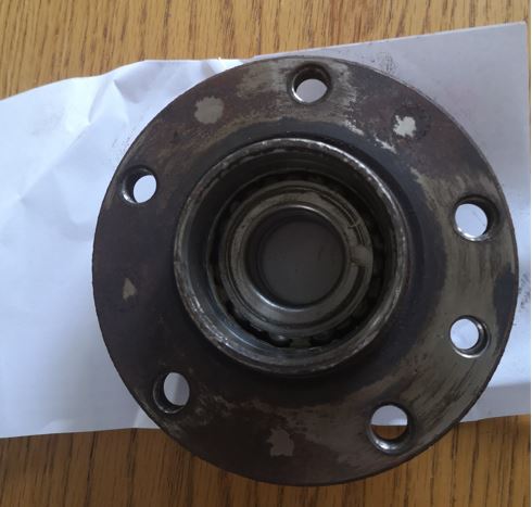

UPDATE...ABS module has power and ground; signal/feed and ground from the module read same voltage as in the sensor. I am now suspecting TONEWHEEL. Diligent research led me to the presence of a tonewheel inside the hub and I have a feeling there is a need to replace the bearing. Initially I thought the smooth surface at the otherside of the rear rotor where the sensor is bolted in was the tonewheel itself ... it is inside the hub where the bearing is located.

I was able to take out the left rear wheel bearing/tone wheel and installed a new one. ABS and traction control lights all gone and cruise control working...I'd say its a FIX.
