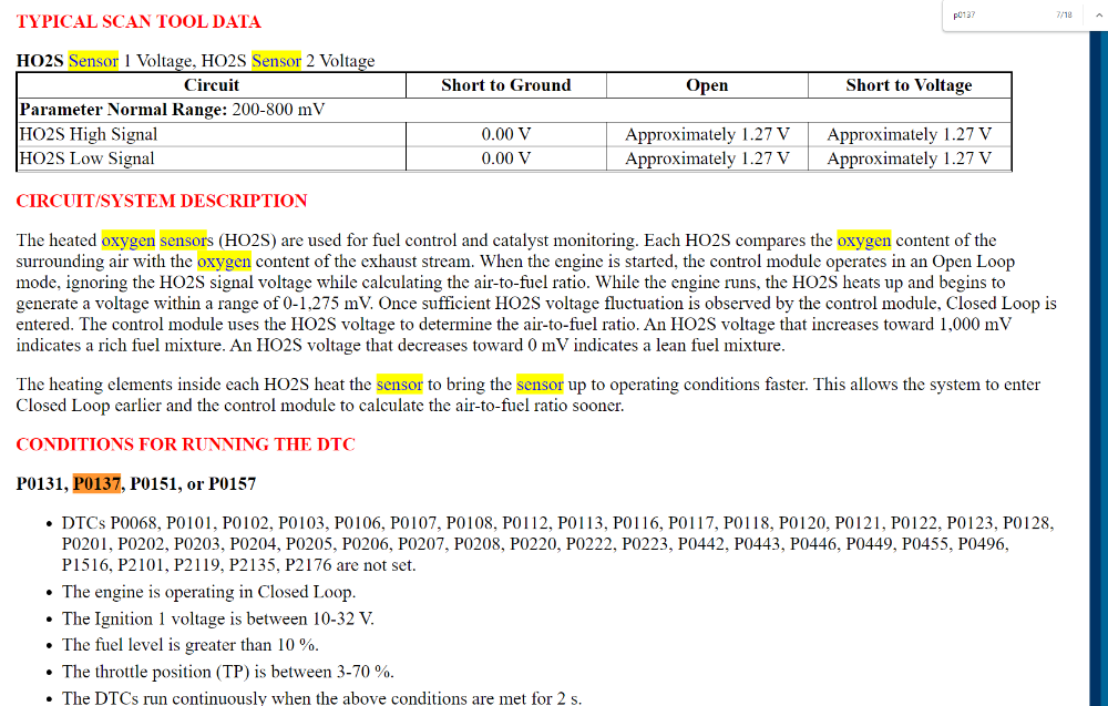

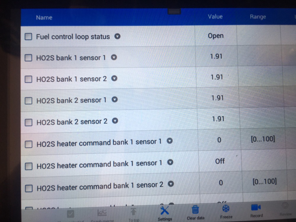

To start with I do not believe they are A/F sensors. Throughout the service manual (Mitchell) it only references HO2S Oxygen Sensors, no mention of A/F sensors.
I am going to start the testing with a cold engine.
With key on and engine off, this is a screenshot of my Autel MS906TS scanner. I cutoff the Unit column, but that is V for volts.
I also attached an excerpt from the Mitchell Manual.
I will next measure the voltages directly at the sensor B2 S1.

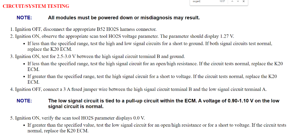

Ok, things are starting to come together and make a little more sense.
I got a little confused with the connections between the sensor's floating ground controlled by the ECM and the chassis ground.
With engine cold, key on, engine off I took readings at the sensor with DVOM.
PPL\WHT High Reference to chassis ground = 2.78 volts
Tan\WHT Low Reference to chassis ground = 1.04 volts
PPL\WHT High Reference to Tan\WHT Low Reference = 1.80 volts.
These readings appear to be inline with the specs in the manual. Of course the scanner is still showing 1.9 volts. Since I am taking the readings directly at the sensor, I am thinking that this may be a slight voltage drop in the harness between the ECM and the sensor. Thoughts?
I am now going to take the readings with the scope with the engine running and compare to the live data on the scanner. I'm thinking that everything will fall into place when I have the probes on the sensors floating ground instead of chassis ground. I'll do it both ways.
Thanks for the replies, it always help to sound thing out.

Ok, this might go off topic a bit, but I am actually learning a lot from this one test. Which is why I think testing is very important to do on know good vehicles.
I have found that if you connect your scope/DVOM to certain connections, such as the O2 Sensor's high reference and the probe's ground lead to ground, it changes the voltage readings shown on the scanner. In my case it dropped from 1.9 volts on the sensor to .75 volts when connected the DVOM.
I also observed that the voltage reading from the scope is different than the voltage reading from the DVOM, must have something to do with the resistance in the probes.
Bottom line is you need to know how different connections and floating grounds can affect the readings.
ScannerJohn, now that I know some of the problems I was having with connections and probes, I will rerun the tests and post the results here along with what probe is connected to what wire.
