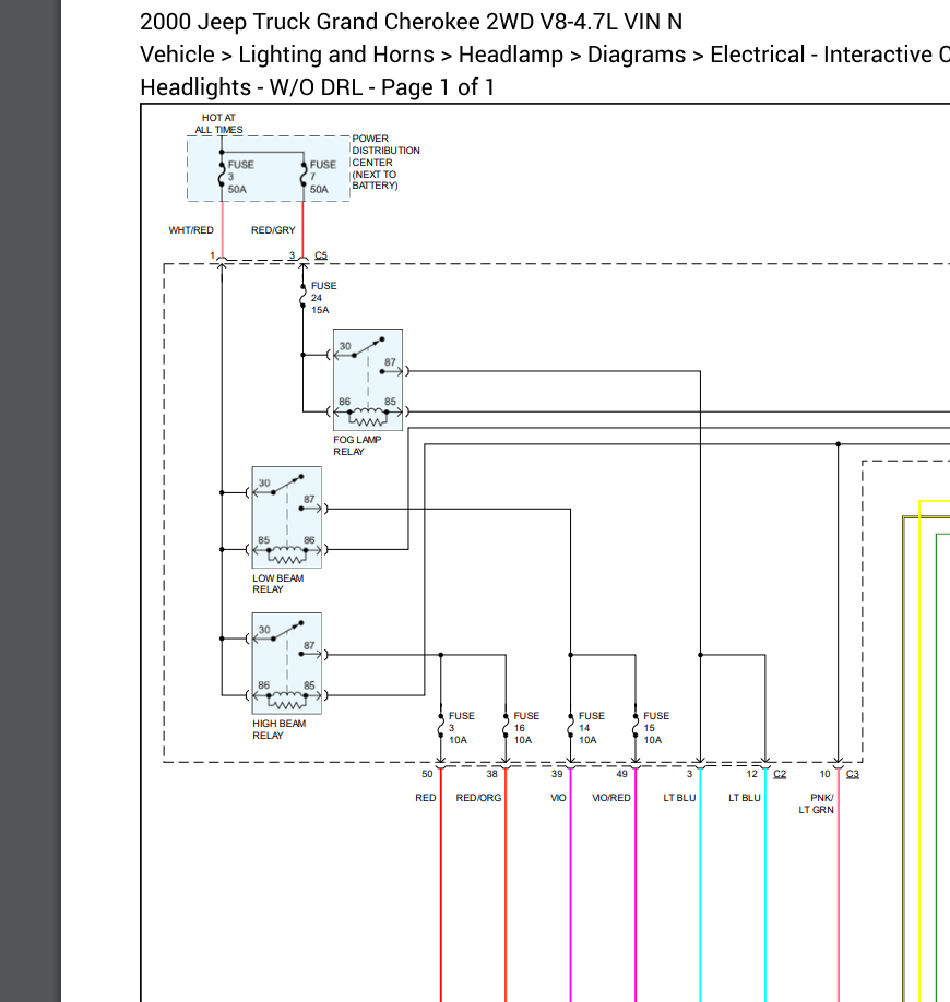

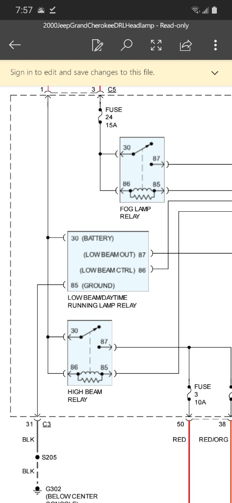

Edit.
Another member left wiring diagrams and on those it shoes both relays as mechanical. I wonder which one is correct?
See the attachment.
Thanks guys!

5 years 2 months ago #50730
by Matt T
Replied by Matt T on topic Jeep Grand Cherokees battery draw
The solid state looking relay is for vehicles with DRL. The regular relay is for those with conventional headlights.
