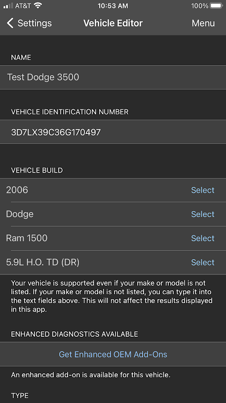

Have you tried manually entering the VIN in the MX+ then installing Enhanced Diagnostics? IME the MX+ will stop if it can't find an ECM when you try to connect automatically. But it will communicate with other modules if you set the vehicle up manually.
If you can't get any direction with a scan the TIPM acts as the gateway for the three CAN networks so that'd be where I'd start testing.

thanks for the ideas - this vehicle not available in the pull down list - Ive asked for support from OBD2 link for manual install of VIN and also whether compliant with the dodge can bus enabled OBD2 port. . I put a new TIPM in this - reason, there are drying up fast on national backorder - there are now a handfull in the country left. But, as usual did not fix prob - digging into wiring today via all data .

5 years 2 months ago #50636
by Matt T
Replied by Matt T on topic 2006 DODGE RAM 3500 Auto 4WD 5.9 DIESEL - NEED HELP diagnosing CAN bus
The following user(s) said Thank You: REM
- REM
- Posts: 19
5 years 2 months ago #50637
by REM
Replied by REM on topic 2006 DODGE RAM 3500 Auto 4WD 5.9 DIESEL - NEED HELP diagnosing CAN bus
skipped over that - yes - Ill try that - thank you very much for the tip - one other thing - alphaobd is also a good app for chrysler - but havent tried it - tha
