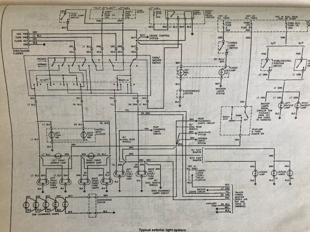

Here's what my Haynes Manual is saying the headlight circuits look like

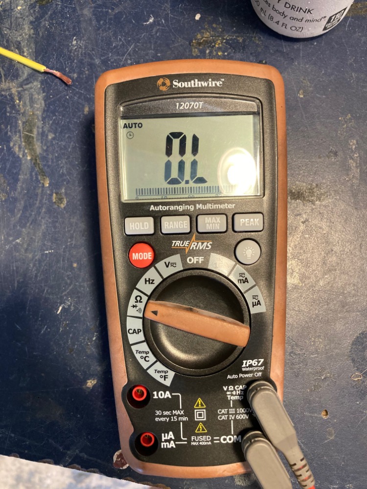

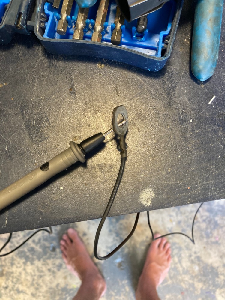

Ok so I pulled the entire headlight harness out of my truck and put it on the work bench.

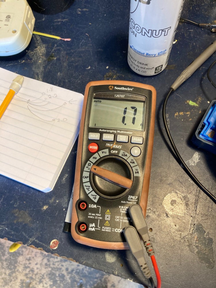

Am I correct in approaching the testing of the harness in this fashion? I want to check the quality of these 5-way connections, it seems I've got like 4 of them across the harness. I want to check the integrity of the connections in the middle
I've got my multi-meter set up like this
Then one lead goes to one end of the wiring circuit.
We travel past the connection I am testing
To the other end of the wire
And this is what my multi meter is reading
Now when I take a fresh wire and read both ends, I get like 0.4

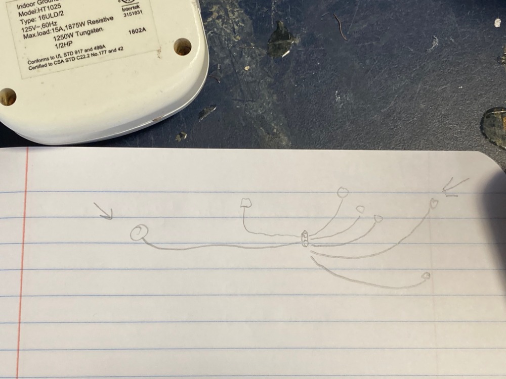

Here's a drawing of the wiring diagram for this specific wire. If I go and check every different end in the same method and everything brings back 2.0, is it safe to say that the connection in the middle is good?
If that is the case, the entire front headlight harness is good and all the multi-connections in the middle. And my problem is coming from the rear harness. I've replaced all my light bulbs, 1 of the day times burns extra bright and the blinker is on rapid fire. I thought I had a problem with the front harness.

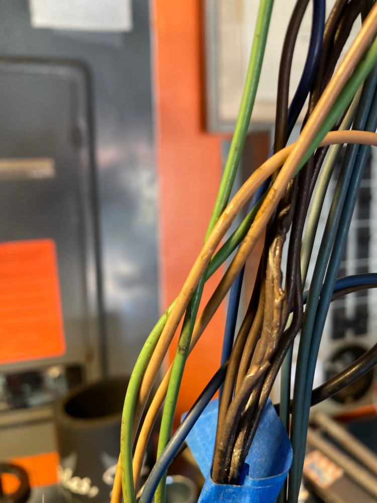

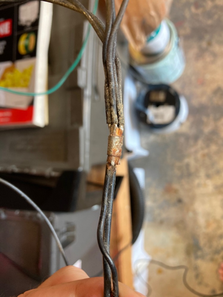

Because if this is correct, my original thought was this one burnt up melted wire, its burnt and melted up in multiple spots along its run. I originally thought this was my problem and the plan was to just replace this wire totally.. but once I checked the continuity of the wire, it brought back 2.6 which is weird... which is why I am not sure if I am testing my wires correctly.
You can see a spot of the burnt melted brown wire in the middle.
5 years 2 months ago #50813 by Scott Tucker
Yeah,,but did you do a voltage drop test or you checking ohms,,ohms won't do any good,,but a voltage drop would have found that bad wire or multiple problems the ground circuit did you get it fixed

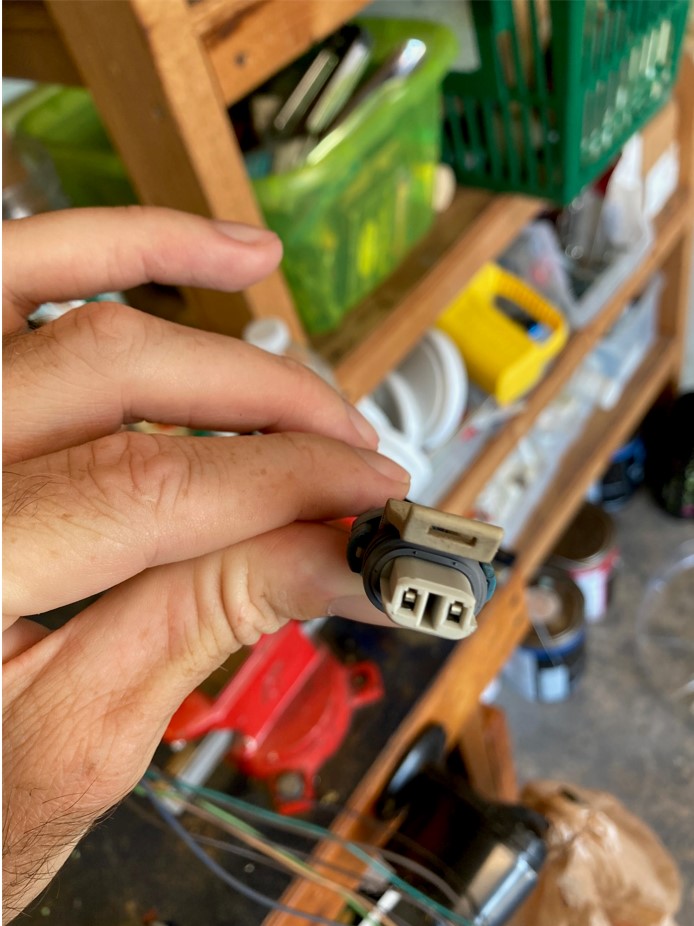

So I just got all new bulbs, replaced the tail light circuit board (it had a burnt up connector) with a GM one...
...and now both sides are blinking fast...
Every bulb works, every bulb is brand new, why would both sides be blinking fast now?!
