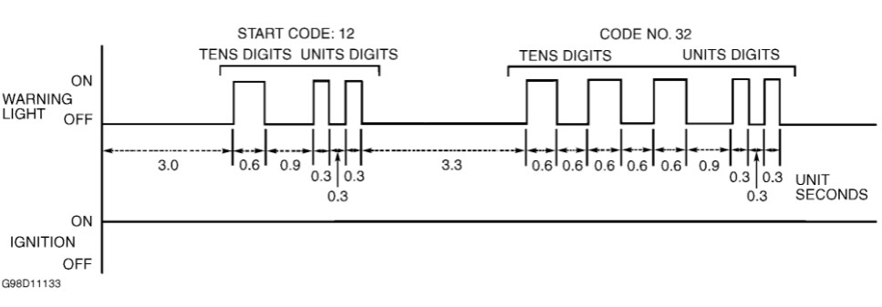

5 years 2 months ago #50786
The ABS light will be harder. There's no scan data, just flash codes and flow charts.
KOEO, ground pin #8 of the DLC and watch the flashing of the ABS light. It'll display up to three codes, most recent first. The sequence will always start and end with code #12. You decode the flashes like this:
As for the CEL, I'd say grab a cheap code reader and keep in in the car. Even if the light isn't on, scan the codes anyway. That'll give us a starting point.
Replied by Tyler on topic 2000 Xterra Intermittent IC warning lights
Agree 100%. If this were in my bay, this is what I would chase first. Maybe you've already checked, but how's the brake fluid level? If I remember correctly, the fluid reservoir on these are tiny. :lol: It doesn't take much to trip the level switch.The brake light stuck on seems like low hanging fruit. Try unplugging the switches.
