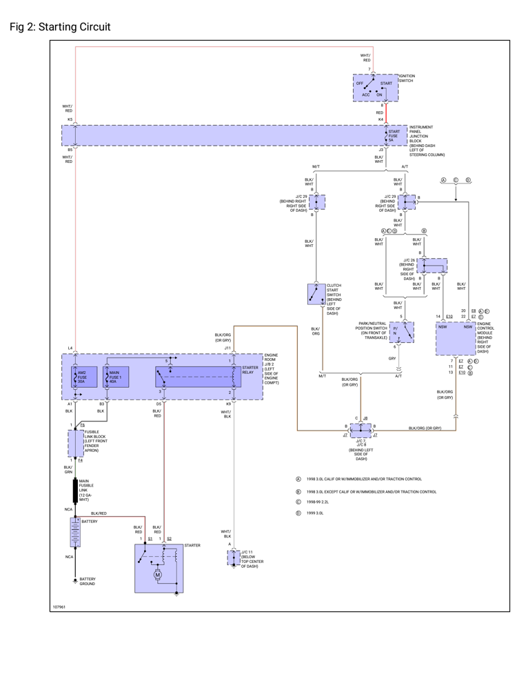

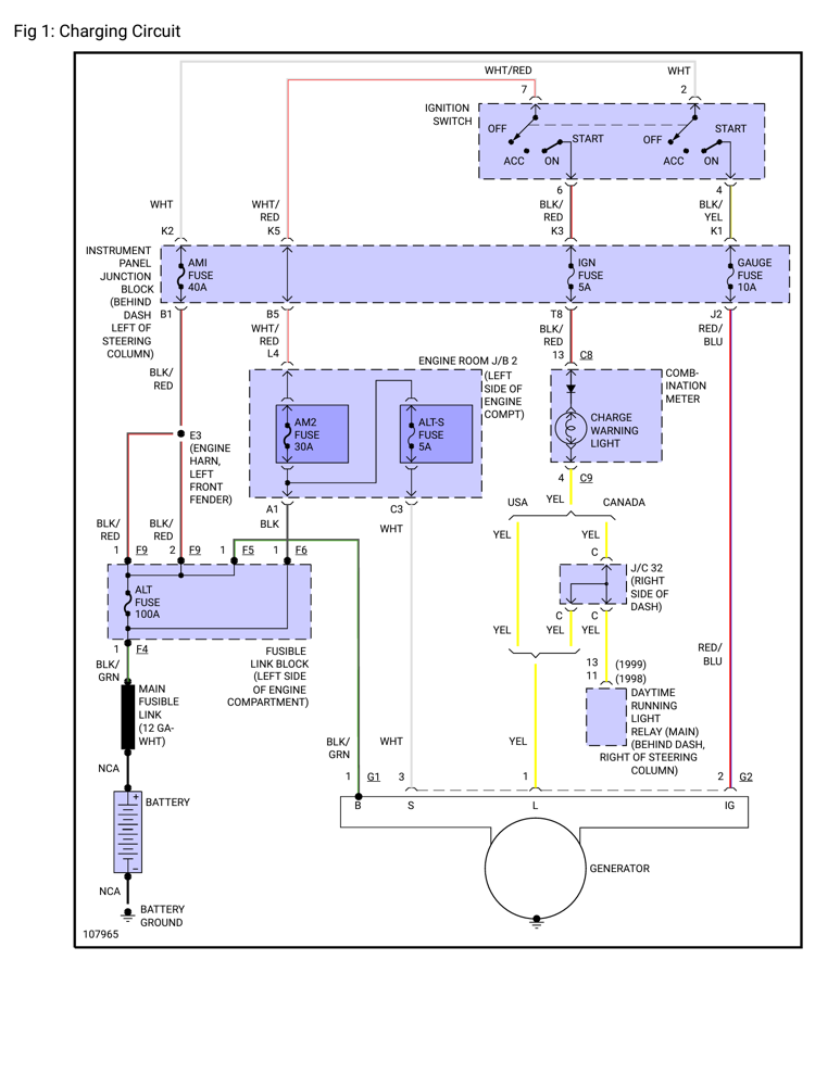

I will try to uphold the wiring diagram because this is where I’m a little rusty on my skills. I will say I did try pulling the big alternator fuse with a pair pliers to see and check it on the back side and come to find out somebody else and hold it up just because the house and it sits in was loose and then I noticed it was bolted on underneath. Is there an easy way to check that big alternator fuse other than unbolting it on the bottom side? Luckily I didn’t break it trying to check it.
could it be possible that they hook the power up in reverse and it blew the fuses first then a fusible link? I’m trying to put my head together and say OK being that there’s no dash lights, no AC and stuff like that I need to find a common denominator in the power supply and check for powers and grounds at that location. That’s where I fall a little short and I will admit the electrical is an always my strong suit. Especially when it comes down to where they are. I have the diagrams I get certain things just sometimes I overthink it.
what would you guys check and where would you check to check this?

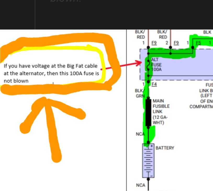

Looking at the large alternator fuse at the front of the engine fuse box panel how do you determine if it’s blown.
Is it really possible that I’m getting this many blown fuses?
Also if the alternator being new is good indeed then regardless of fusible links, fuses, etc shouldn’t I be getting more than 9.9volts I believe it was at the alternator with the positive on the single wire post and the ground grounded to the alternator, engine block below or even the ground at the battery or any other grounded location for that matter or does something have to trigger the alternator internally before it’ll produce proper voltage, exciter wire possibly, I think I read in a online search? Just has me scratching my head on this one.
Diagrams will be attached if possible.

5 years 2 months ago #50739 by jreardon
Replied by jreardon on topic Alternator Issues 98 Toyota Camry 2.2
Take some voltage measurements at the plug too and report back if anything's weird. If you have no voltage, back track to the fuse and check there.

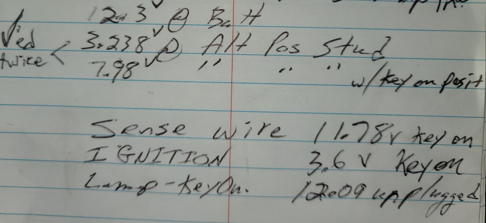

Here’s what I’ve found. Bout to dive under dash and check fuses from when I checked with Ohmmeter the other day it indicated bad fuses.
See attached photo for readings @ alternator.

These are the voltage readings at the battery, at the alternator plug with the alternator plug unplugged using a 4mm plug fine needle probe plugged into the multimeter wire harness.
Last edit: 5 years 2 months ago by Dtnel. Reason: Posted photo twice by accident... Lol...
5 years 2 months ago #50765 by jreardon
3.6V on the IG wire's bad. Check the Gauge fuse with a test light. If it lights up nice and bright there, the problem's between that fuse and the IG wire to alt. You can also just jumper a fused wire (temp fix) to this IG wire and see if the alt will kick on.

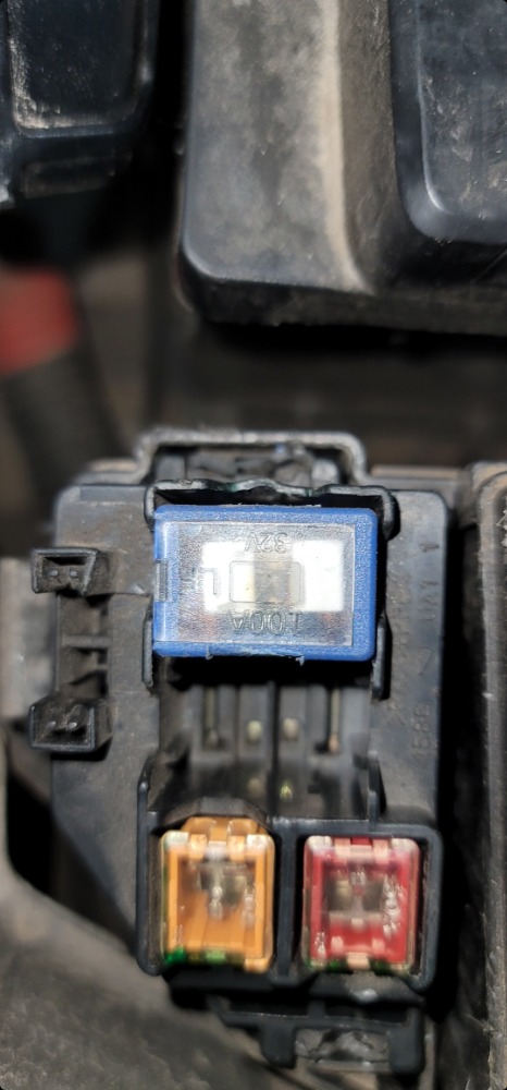

Looking at the fuse when working on this something told me something wasn't right. Also we had readings that basically told us what we've always been led to know that's apparently the fuse was good because we were getting voltage readings. Knowing what I know now instead of wrapping a couple hours into this I should have pulled the alternator fuse and checked resistance. It was a big lesson learn because when I pulled the alternator fuse and check resistance we had all types of resistance. Checked it against a new alternator fuse in the package by piercing a small pin hole through each side and use them back probe connectors to check and make sure I was getting a different reading off the fuse in the package before I opened it. The old alternator fuse had it where you had to actually remove the screws. The new alternator fuse you can push down in with the screws loose and then tighten down the screws on each side were they bolt in. I will try to dig up a picture of the fuse because looking at it afterwards it makes sense even though I had a voltage reading.
 I had actually seen this neighbor on a couple different occasions trying to start it, the car to which they couldn't get it started. With the fuse being blown it makes sense because the fuse blowing protects the system though it did take out the fuel pump fuse as well. Once I installed the new alternator fuse I gained all accessories, heating and air conditioning, tail lights, brakes, windshield wipers, door locks, electric windows and any other accessories that weren't working.
 I will chalk this up as going with my instinct to begin with which was to pull that fuse initially but reading your post it made sense so I didn't want to go down the rabbit hole again like I did on the alternator. Luckily for me and them I was able to get that alternator warrantied. It was a Remy remanufactured alternator.
The lower left fuse is listed as CDS in the fuse box. When I removed the fuse only 1 spade was sticking up into the housing. Wonder if "CDS" was a option that was an added on this vehicle? The lower right fuse however did have two Spades coming up into the fuse.
 makes me wonder if this fuse box was replaced at one time and it's life or another.
