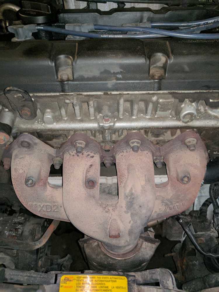

Hi,
I am working on my mom's 2003 Hyundai Elantra GLS. The car throws a DTC of P0133 and has for some time. I have watched ScannerDanner's videos on his premium channel where he states that 99% of the time, the code indicates a faulty O2. However, after checking the car's service history, I see the O2 has been replaced twice. I initially believed the code to be cause by a leak in the exhaust manifold since I found there to be a stud missing(image attached). If you look closely you can see there are two vertical cracks around the second and fourth and lower nuts. It doesn't seem like there is a leak coming from there however. Anyways I put in a new stud, replaced the exhaust manifold gasket, and installed new nuts to 40 ft*lbs working from the center out. I completed two drive cycles and during the second drive cycle, the MIL illuminated halfway through as usual with the same DTC.

Sorry to hear the manifold didn't fix this one. :( Not a misstep on your part, IMO.
There may be something to pulling the ECM fuse, or doing a soft reset. Engine computers can be funny about what they keep in memory, and this wouldn't be the first vehicle to have an emissions concern fixed with a battery disconnect. Nothing to lose by trying this!
While we're on the subject, how's the battery connections themselves? The O2 signal you're describing sounds like the signal tends to hover rich for too long, which could be explained by an excessive voltage drop across the O2 signal ground circuit. Block grounds and battery connections are highly suspect, in this case. This could be easily checked with a voltmeter.
I see that the downstream catalyst got replaced, but how about the downstream O2. I know you've got a code for the upstream sensor, but I have seen some vehicles that compare the two sensors to each other as part of the O2 monitor. A strangely behaving downstream sensor can actually fool the ECM into thinking there's something wrong with the upstream. I'd suggest watching both sensors during a test drive, make sure that the downstream swings full rich and lean. You can force both conditions by doing a WOT acceleration (rich), and during closed throttle deceration (lean).

After pulling the battery connection and running another drive cycle, the P0133 was replaced with a P0420. So I think the code was somehow stuck in memory. Pulling the battery connections, which caused the ECM to reset fixed the issue. I know the cat is shot on this car, so I believe the P0420 DTC to be justified. Thanks for all your help everyone.
