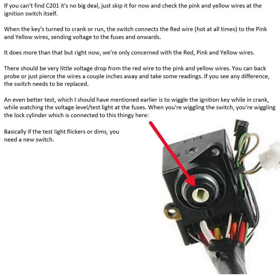

It's probably not more than a foot away from the ignition switch judging by the length of this cable bundle:

Ok so if the voltage drops and I need a new switch, is that switch the other end of connector 201 or are we looking at another part. Here's a little back info at this point. My mechanic crossed my starter over for me while I tried to turn the key and it still wouldn't start. That's why he thought security. So with what I just told you, him crossing the starter over the engine cranks like hell but still would not start at all. All while I was wiggling and engaging the key to the full on position back and forth. Does that help you in any way. Yes it was redneck, but he felt if it wasn't an electrical issue, and it started and ran fine, that we could have routed a push button start, overide it straight to the starter and be the same difference. But no, the car cranked perfectly, with the ignition on, me fiddling back and forth, while he engaged the starter. Car cracked perfectly but, it never picked up and ran. Thank you.

I found the piece you pictured for me to test. I used the piercing method. Roughly 6 inches below the " thingy " as you called it, I pireced the 3 wires and here are my results.
In run position
Red wire: 11.8v
In crank position
Yellow wire: 11.80v
In crank position
Pink wire: 4.72
Please respond with what part I specificaly need. And if you could kindly send me the rock auto link to purchase it. Or what category and specific name in rock auto system. I use them exclusively. I can't thank you enough for your easy to follow commands, diagrams etc. I appreciate to the millionth power.

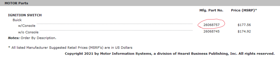

I'd like to thank you both very much for getting me this far. The question I have at this point is which switch to purchase and if I need to purchase only the switch that is attached to the other end of the connector 2010p0 do I need to buy some other material as well. Last thing I would like to let you know is that I have a  floor shift model. automatic transmission in my car. So if you can get back with me on what part you think I need I would really appreciate it. Thank you and have a great night.

I see two part numbers for the ignition switch: one for "with console" and "without Console." By Console, I'm assuming they mean the console-mounted floor shifter maybe? I'm not sure.
So the part number I would get is 26068757, so that's the GM GENUINE part from Matt's link: GM GENUINE D1491D {#26068757}.
4 years 11 months ago #51415 by jreardon
I don't know, you need to pull out that part and compare photos.
You're welcome on the link. Rock Auto sometimes hides stuff........
I think you're right about console being floor shift. D06 looks like an RPO code so maybe take a look at the RPO label just to confirm it's the correct one.

4 years 11 months ago #51422 by Probinson0977
So do I need to purchase the ignition lock housing along with parts labeled 16 and 19 all in the red squares on the right hand schematic? Or merely the cable and the switch it is attached to that I tested the red , pink, and yellow wires. Please don't be frustrated with me at this point. I'm just bouncing around from reply to reply and it's confusing me. I'm very sorry to inconvenience all of you.
4 years 11 months ago #51424 by jreardon
Just the cable and the switch it's attached to :) Part number 26068757

4 years 11 months ago #51432 by Probinson0977
I realize now that the part that I need for my car cannot be bought for $30. I do see the cross reference( matt) from the GM original part number which is 26068757. And I was able to find  the GM equivalent on the Rock Auto site. All of the options that are on my regal match the options that are related to the ignition switch. That being the front console, with tons of storage, containing a cigarette lighter, ashtray as well as another 12 volt outlet on the passenger side of that console, the gear shift which is on the floor as well, and the rear console that can be used to rest your arm on. It also opens and contains a spot to hold change and a lot more items. I'm not 100% sure but I think it has a bulb light in it as well. So with all of those different things needing power as well as the fuse box on the passenger side needing that power to crank the car and also reliably feed those with the correct voltage makes a huge difference in what ignition style was needed. I want to thank you Matt and the other user name jreardon. After I receive and install the part I will drop in and let you know if I hear the wonderful sound of a 3800 series II  pumping and thumping in time.lol
