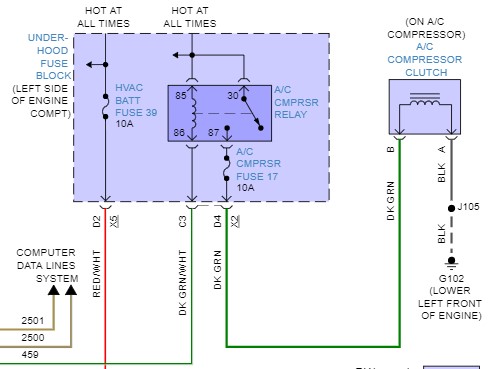

Your other option would be to jump the compressor. Here's a diagram for reference:
You can jump the relay if you're comfortable? But I'd suggest jumping 12V to fuse #17 A/C CMPRSR instead. Less chance of inadvertent damage.

I’m not to good at wiring like danner said if you not to familiar with it you can cook a computer….but if I tried would I jump pins 30 and 87 to make the compressor come on?
5 years 2 months ago #50967
You can definitely jump the relay pins. But, since the A/C CMPRSR fuse is after the relay, you can jump power to the fuse directly and not have to worry about making sure you're on the right relay pins.
Zero chance of letting the magic smoke out of the PCM that way.
