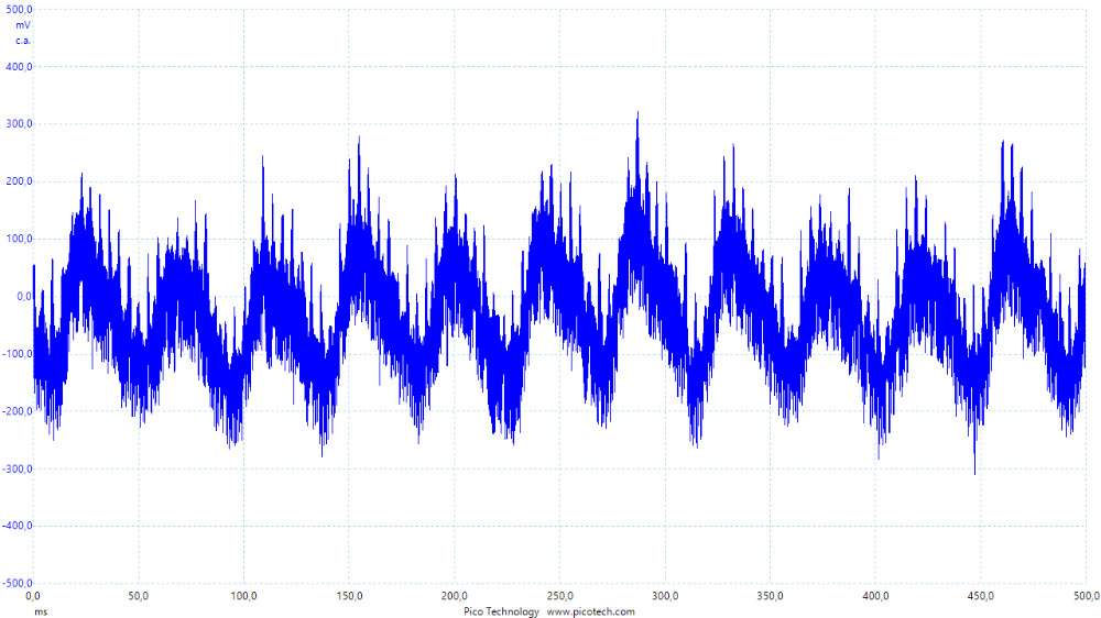

Hello,
I'll try to write in my best english...
I had a problem with my car 2 weeks ago: when driving at fast speed, the battery light randomly flash before staying continuousely on, then other warning light appear, steering assist go away, speed indicator make 0-200 kph twice in a second, dashboad bips.... I stopped the car and it does't restart The repairman did a quick test on the parking and accuse the alternator. Some days later the garagist tell my that nothing is to be repaired because everything is ok: he did a decharge/recharge of the battery (ok), alternator is charging, warning leds are off, he drive with all electric load at max usage and everything was looking fine.
Nevertheless I sometime experienced some battery light flashing but not the same nightmare as the first time.
The battery is old (2010) but appear to be working fine :
- 12.6V car OFF
- 12.45V car ON, motor OFF
- 11.7V car ON, motor OFF and light+ventilators ON
- 14.3V motor idle
- 14.4V motor at 3000rpm

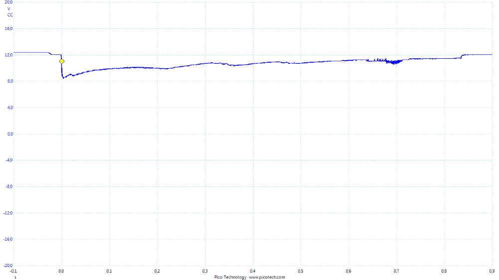

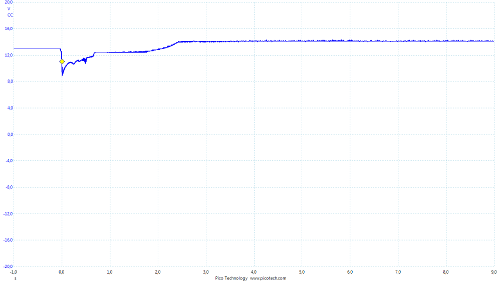

- 8.5V during motor boot (voltage monitoring attached)
Battery voltage, starting motor (1s):
Battery voltage, starting motor (10s):
The voltage drop across wire between alternator and battery is fine (20-30mV)

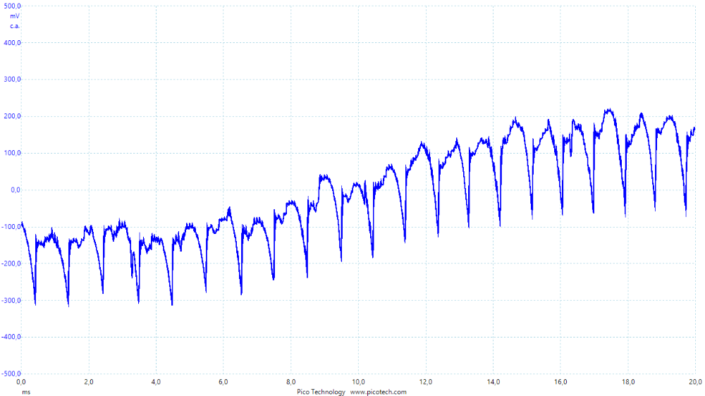

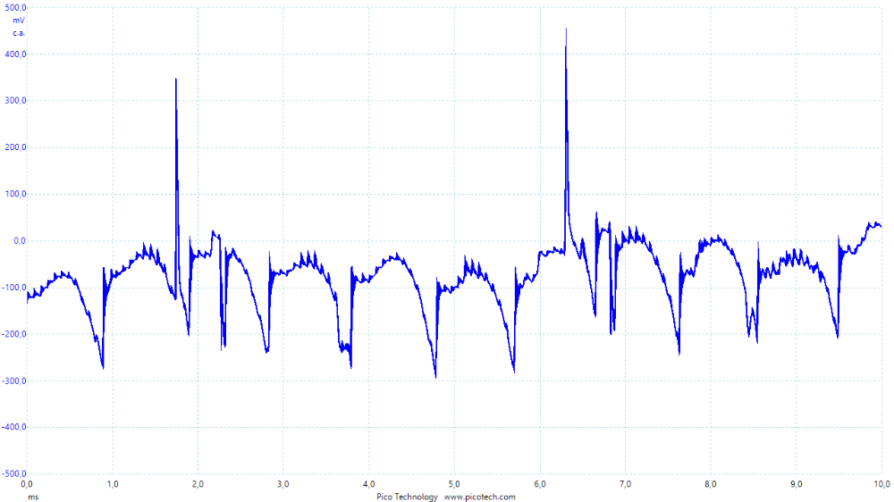

The ripple at alternator output looks more suspicious. I'm not sure to well interpret them. Spike are from ignition, but ripple and general waveform are not very clear.
Car is Skoda fabia II (2010) 1.2TSI
Alternator is Valeo 03F 903 023 E
Alternator output voltage, 20ms snapshot:
Alternator output voltage, 10ms snapshot:
Alternator output voltage, 500µs snapshot:
Any help appreciated, thank you!

Can you check the voltage while running on an AC scale?
- gibrocksone
- Posts: 3
5 years 2 months ago #51106
by gibrocksone
Replied by gibrocksone on topic Alternator diodes dead?
Not sure to understand what you mean: my alternator voltage captures are already AC-coupled?
- AJeep18
- Posts: 174
- Thank you received: 34
5 years 2 months ago #51109
by AJeep18
Replied by AJeep18 on topic Alternator diodes dead?
Sorry I should have looked at your voltage scale closer. On page 8 of the SD book he says: maximum allowable AC voltage is .3v (300ma). Was this test done at the battery or on the alternator stud. Either way that looks like a bad diode to me.

ok, so I'm very close to the maximum... The voltage is taken at alternator stud.

I don't think you have an alternator issue I would suspect you have a loose arcing connection some where.
5 years 2 months ago - 5 years 2 months ago #51159
Also, keep in mind that higher-than-normal AC ripple can be caused by a weak/discharged battery. If your battery is from 2010 like you stated, it's time for a new one.
Replied by Tyler on topic Alternator diodes dead?
Exactly what I was thinking. Alternator ripple doesn't account for a no crank/no start. Maybe, if the ripple was extreme? But it'd need to be a lot more than what you're seeing.I don't think you have an alternator issue I would suspect you have a loose arcing connection some where.
