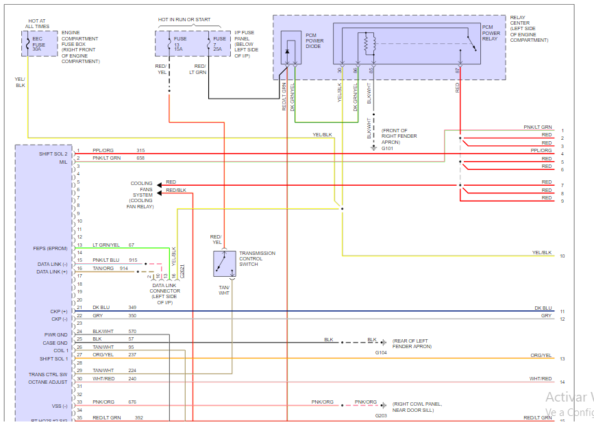

3. Voltmeter battery voltage is 0.35v (0.5v today) above PID. Line between EEC fuse and pin 30 of center relay is having that voltage drop (see attached). Now i'm going to check fuse 7, which is the power line for coils.

I wouldn't sweat the discrepancy between measured open circuit battery voltage and that PID. You gotta figure there's gonna be an accumulated voltage drop in the various wires and connections between the battery and the PCM, especially on circuits with higher load. The rule of thumb I always heard in tech school was 100mV per connection. That's not a hard and fast rule, just a general allowance I use when making measurements.

4 years 11 months ago #51385 by guafa
Replied by guafa on topic 96 mercury grand marquis bank 2 lean code
Hey guys,  i found something else.
While car was sitting, everything closed and pcm sleeping, something was draining 3 amps from battery. The battery voltage dropped to 10.9v
There is a starter/generator fuse which goes to internal generator regulator which is draining that current.
This could be related to misfires and underreporting maf readings but i need to verify.
