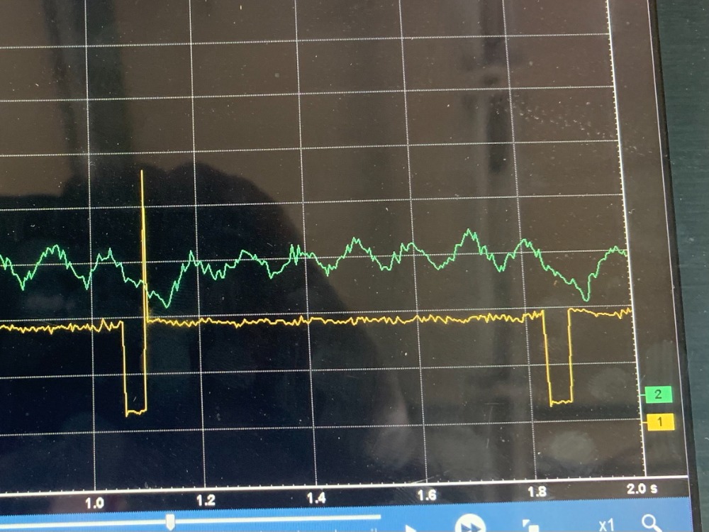

Okay guys this one is taking me for ever to diagnose. It runs bad! No codes but seems to be misfiring bad. The back 02 sensors are fixed rich. But no O2 codes. I did a relative compression test and was using a coil to mark my cylinders and the coil don’t have spikes some times. It shows it being pulled to ground but no spike. On the relative compression test it shows one cylinder that I’m using the coil on is better then the others. At first I thought 02 sensors but it runs bad as soon as it starts and it’s hard to start. Any ideas? I will try to send pics of my relative compression test in a min.

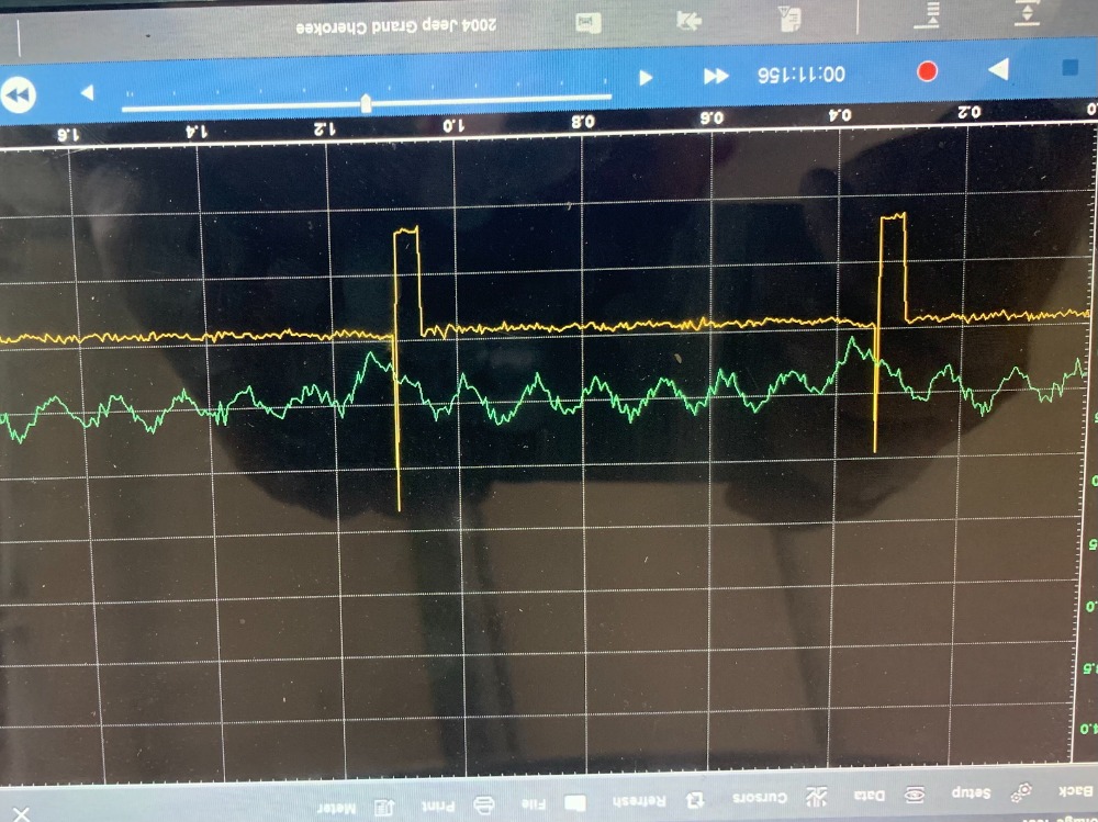

Okay I guess I don't know how to count   I was looking back over my relative compression test pictures I don't know how I missed this. It looks like I only have 7 vvvvvvV and one is big. I'm using this tablet so I think I can post a picture. Man this one was driving me crazy! Im pretty sure that is also the cylinder I did a compression test on and it showed over 100psi. So what could make it draw down like that and show good compression?????stuck closed exhaust valve? I'm going to try to send a picture that shows the spike missing on the coil too

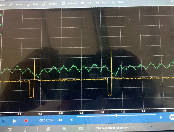

Replied by Mike T on topic 2004 Jeep Grand Cherokee 4.7 problem
Here is the other pic

I grabbed your first pic and inverted it for clarity:
Definitely a low cylinder. What were your scope settings for this capture? Which ignition coil were you connected to?

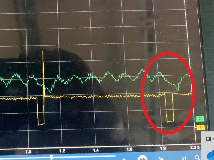

In your second shot, is this the missing spike you're referring to?
I think this comes down to your scope settings. Snap-On products will need Peak Detect turned on to catch detail on ignition events like that. It looks like you're on a two second screen? That should be just fine. But don't be afraid to make the Zoom function work for you, if you aren't already. ;) Try one second or 500ms.

I’m pretty sure it was the #2 cylinder I had marking on the relative compression test.
I didn’t think nothing about peak detention! I was going down the rabbit hole lol thinking it only don’t have compression sometimes that was why the spike was only missing sometimes. It’s really good to have this forum to be able to talk to others guys about scope testing! I haven’t heard about anyone else in town using a scope. I might be the only shop in town that uses one lol I know a few people that have them but don’t know how to us them lol I really appreciate your help!
4 years 11 months ago #51560 by Tyler
Replied by Tyler on topic 2004 Jeep Grand Cherokee 4.7 problem
No problem at all! :cheer:
If your ignition trigger was on #2, then I think you've got enough evidence to revisit compression and leak down on that cylinder. Let us know what you find!
