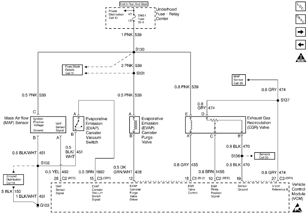

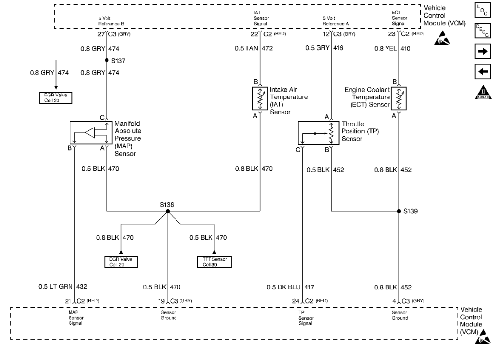

4 years 11 months ago #51417 by jreardon
Your reading of 12 volts at the VCM Connector 3 terminal #27 does not jive with the 5 volts you said you got at the MAP and EGR. Are you sure you were on the gray wire at the VCM?
i.imgur.com/bRniQ3O.png

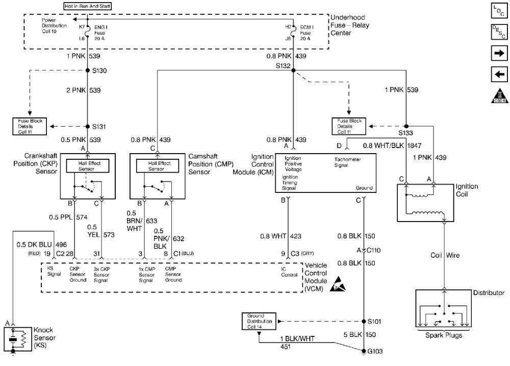

4 years 11 months ago #51418 by jreardon
Noticed Ignition voltage 1 low when cranking on MATCO Determinator Scan Tool.
Do a voltage drop test on this Pink wire referenced to B+, while cranking at connector 1 of the VCM pin 4.
4 years 11 months ago #51419 by jreardon
Can see test light flicker at Ign Control Mod and at Coil signal wire.
I have noticed spark out of coil wire come and go on two different occasions. No spark now.
Do you still have signal to ICM on the white wire, while it's a no spark? If you do, how's power and ground?

4 years 11 months ago #51435 by VegasJAK
Mitch,
jreardon has you pointed in the right direction. To state the obvious, you have to have constant spark to get the engine running.
Start at the easiest point. The coil and work your way back along the signal path. No spark on the coil wire, move to the coil. Re check the pink wire for 12v then check the white black wire for a pulse signal. You need a scope but a test light will make due. Your test light should pulse, if not move to the ICM. Again check the pink wire at the ICM for 12v and a pulse signal on the W/B wire. If no pulse move to the White wire and check for pulse. Then to the VCM and again check the white wire for a pulse.
If no pulse from the VCM move to the crank, cam and knock sensor. The pink wire is again the power source for the cam and crank. The yellow is crank sig and the BR/WT is the cam sig.
You may know all this but assuming makes diagnosing harder. If you follow a path from your testing you're more likely to find the problem without throwing parts at it.
Let us know your progress. We all want your van running.
4 years 11 months ago #51465 by Mitch
With a volt meter at C1 pin 4, (pink wire), and another volt meter at pink wire at coil connector. With key on there is 12 volts at each meter. While cranking, voltage drops to 5 at both meters. Butt connected a new 14 ga. wire at C1 pin 4 wire and at coil connector. Same result. Why is the ECM going from 12 volts to 5 volts while cranking?
