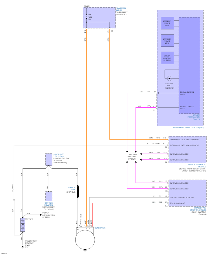

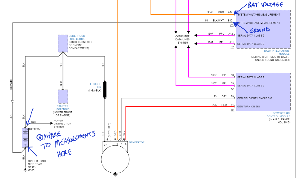

Man, I was wrong on this system (we talked on YouTube for other reading this). You were right about what you read in you Haynes manual! I really hate those manuals and let that dictate my thoughts lol
From looking at the diagram the Dash Integration Module is the one that is the brains in the system BUT it is NOT the one controlling the alternator. The ECM does this on the gray wire (pin 29) "Gen Field Duty Cycle Sig" and then it also sends a turn on or wake up on the red wire (pin 61) Gen Turn On Sig.
The Dash Integration Module talks to the ECM via a class 2 network and tell is what to do based on the two inputs it sees on (pin A12 and B12), these are simply battery voltage and battery ground inputs. This is where we need to focus in my opinion based on your symptoms.
So we need to take direct measurements from these two locations (if possible) and compare to what you read directly at the battery.
Do you have the ability to see data on the Dash Integrated Module? If you do, then we can maybe skip this step (direct measurement), at least initially.

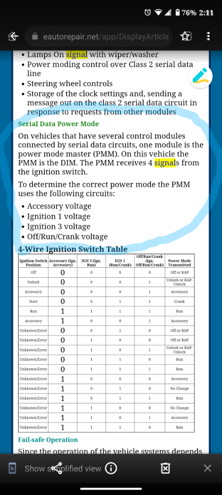

We have to be careful sharing service info here. If you need additional help with this as far as component locations and other service info. Here is a link to the DIY version of this program that I am using.  eautorepair.adtrk.biz/?a=10817&c=24&p=r&s1=

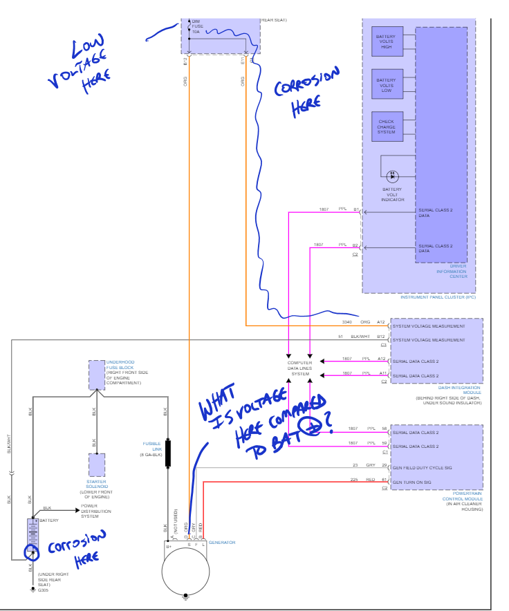

4 years 11 months ago #51442 by ScannerDanner
I think you may have a poor signal getting to the Dash Integrated Module (low voltage on the battery positive sense wire or poor ground on the ground sense wire) we need to measure these to confirm. Also do the measurement I am calling out in this pic, this will answer the "low voltage here" (at the fuse) I have stated in the pic because it is shared with the alternator on that pin and the DIM.
Also as an easy thing to do, that battery ground cable, right at the battery, is a split cable and right where they connect together, we want to take that apart and clean those areas really good.

I do not happen to have a scan tool that can read that data. I only have a 20$ obd2 that i can use with an app but it doesnt communicate with modules. I can read the voltage at the sources. I have the same exact manual u have actually, now i realize its not a hanes manual. But anyway i can get a reading. So ground and power at the dim and ground and power at the ecm ( on those pins of course) and compare to battery voltage correct?      Side note after watching hours apon hours of your videos for the last year and a half and having no mechanical experience i am proud of myself that this is the direction i was going in which is a hard diagnosis bc most cars its just the regulator or ecm controlling it and also so grateful for the experience in diagnosis ive gained by watching your videos. So much more to learn.  Not trying to kiss ass btw just honesty.

4 years 11 months ago #51445 by ScannerDanner
Something else that is VERY important. ALL of your voltage measurements should be compared directly to battery ground, right at the battery, NOT the frame or body especially because of the remote location of the battery. And when you do your ground tests, it will be ground to ground voltage drop tests NOT resistance okay?

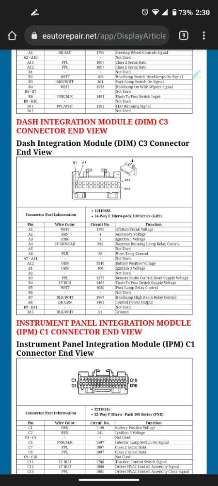

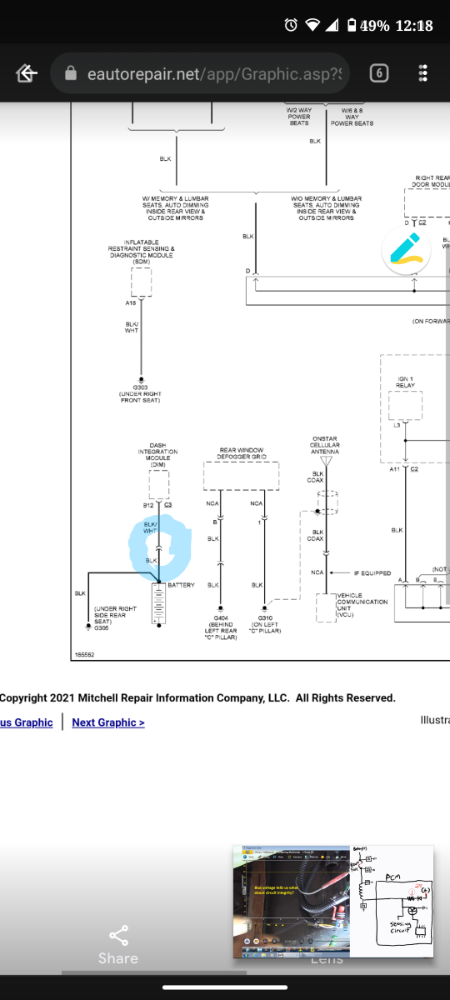

Ok guys. Sorry been busy with work. So far i have measured voltage at connectors a12 and b12 of the DIM module. Orange wire (a12) to ground on battery, same as battery voltage. I was reading 14.67.. ground (b12) to ground on battery was weird to me bc it read only 0.00. check my connection and still 0.00 on ground.

4 years 11 months ago - 4 years 11 months ago #51593 by Confidential 007
    Today i was testing voltage on these wire (pic inserted) i also just happened to test the daytime running lamp relay control. Everything mentioned on pic was the same voltage 14.7.. but the drl relay control wire was 15.23.. the control output wire (b8) was 14.23.... Led dimming signal was 10.4 key on engine off. Everything else was measured engine on. i think i might be onto something. Jus not sure what now lol.

4 years 11 months ago - 4 years 11 months ago #51627 by Confidential 007
So i have a .5 voltage drop on my ground wire from engine to frame... orange wire checks out ok (at rear fuse box) ground is still a little weird to me at the dim.. but going to change my ground wire that is clearly corroded as well...Field duty cycle wire voltage is 3.6 at idle and drops to close to 0v when given gas.. so now i have to check that wire at the PCM to see if im getting 5v at PCM and only reading 3.6 at alternator. Theoretically it should be closer to 5 at idle im guessing? But thats where i need ur input.. I had to go through more scanner danner schooling to learn more electrical lol.. thanx for the parking light short to ground video on ur neighbors charger and all urs and ur brothers help. Much respect
