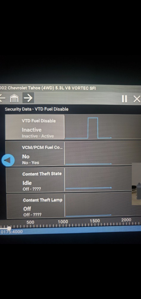

2002 chevy tahoe 5.3  vin z flex fuel. Crank no start/ starts but dies right away. I lose injector pulse after it starts. The computer shuts fuel off but there are no codes. Will run with starting fluid

What are you using to determine you are losing injection pulse? Oscilloscope, noid light? Have you checked fuel pressure? If so what is your pressure?
5 years 1 month ago #51450 by Cheryl
Does the vehicle theft fuel shut off display yes?

I believe my scanner is active and inactive. And it activates while cranking. So yes

Loss of injector pulse after 1 - 1 1/2 seconds is a classic symptom of Theft Deterrent Security.

Thank you! I've been trying this but I can't get it to learn. How would you go about testing the resistance from the passlock? Would getting a resistance reading from the signal wire to ground be a valid reading? In my case there are 3 wires of the ignition cylinder. Yellow wich I believe it's the signal from the passlock to the bcm, orange and black with is ground referenc and red n white with is battery voltage. If getting resistance reading from the signal wire is an accurate way then I'm only getting OL

Let's back up a bit, though.  When you first try to start the truck, and it dies after 1 - 1 1/2 seconds. Then  you, immediately try to start it again. Does it start die, again? Or, does it just crank?  Anti-theft will lock out the injectors for 10 minutes. Any attempts to start, after the first start/stall, will result in a crank, no-start for the next 10 minutes.

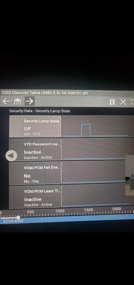

What does the security light do? Does it come on, and go out. Does it come on and stay on? Does it flash?
Does  your scan tool have access to  the BCM? There should be a pid for the passlock signal voltage  (yellow wire). Key on-Engine off. Voltage should be 5 volts. When you turn the key to that CRANK position, and release it, the voltage should drop. This voltage drop is what the BCM is "learning" when you do a security relearn/reset. You can, also, back-probe the yellow wire. Report back with what voltages you have on the yellow signal wire.

It's starts back up it doesn't go into the 10 minute lockout mode. I can start it back up for 1 sec. After a couple seconds. The security light is not on but in the scan tool it says it comes on then Goes off. I noticed that the 5v signal never drops after turning the key.
5 years 1 month ago - 5 years 1 month ago #51659 by Chad
No codes and not locking out the injectors for 10 minutes makes me think that it is more than a security issue. However, if you have no voltage drop on the yellow 5 volt signal wire, then you DO have a security issue. Are you testing the voltage at the sensor, or the BCM? If you are checking at the BCM, you need to go check at the sensor. Make sure you have a good power and ground at the sensor, too.  If you have good power and ground, then the 5 volt signal should drop when the key is turned to the start position. If it doesn't you need a new sensor.
The signal itself is only pulled down while the key is in crank.The Passlock Data Voltage PID "latches" at the value measured in crank when the key returns to run.

Ok thanks guys for the help. So mu conclusion is the passlock sensor is faulty since it's not causing the voltage to drop since I have ground and voltage on the other wires. Also, l found this video about how there are 2 modes for the lock out 1 for 10 minutes and another for 4 seconds.

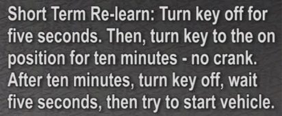

This is the link explaining the difference of the short and long fuel disable.
5 years 1 month ago #51679 by Chad
The primary difference between Short Tamper mode and Long Tamper mode is the  reset procedure. You can tell that you are in Short Tamper mode by the SECURITY light flashing for 4 seconds, then remaining on. The reset  procedure for Short Tamper only takes 10 minutes...Turn the key on, but do not try to crank the starter. After 10 minutes, the security light will go out. Key off, for 5 seconds. Then, start the vehicle.
