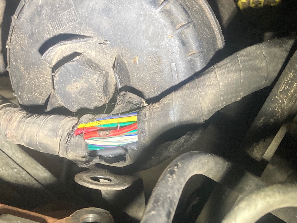

I don't know about the rest of you, but there is nothing like the feeling of satisfaction you get when you find a problem, solve it, and get the customer going down the road. Even if it isn't a difficult problem I still enjoy it. Anyone else rather do this kind of work instead of brakes?

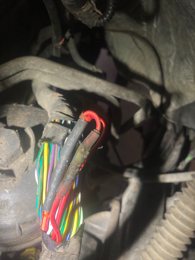

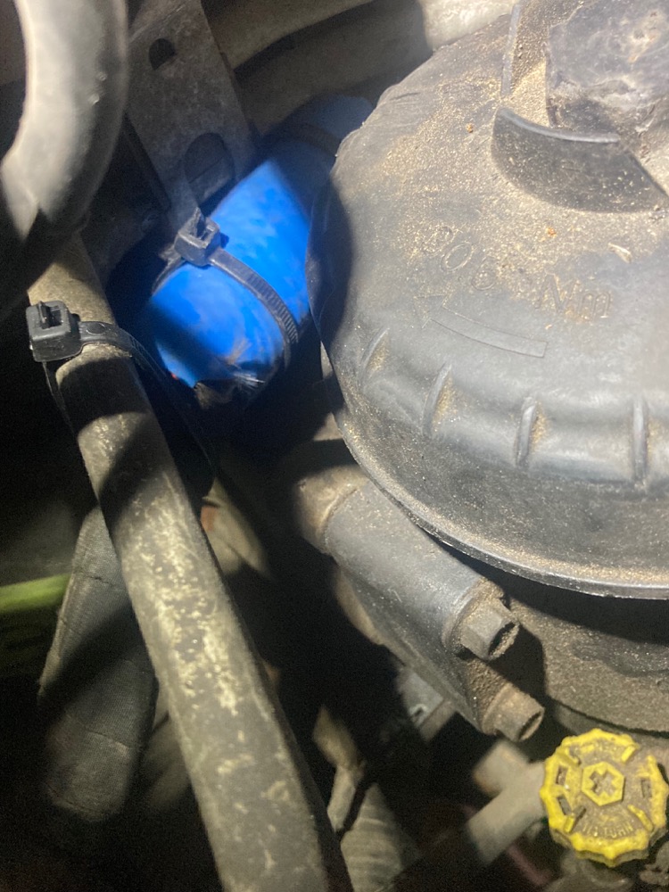

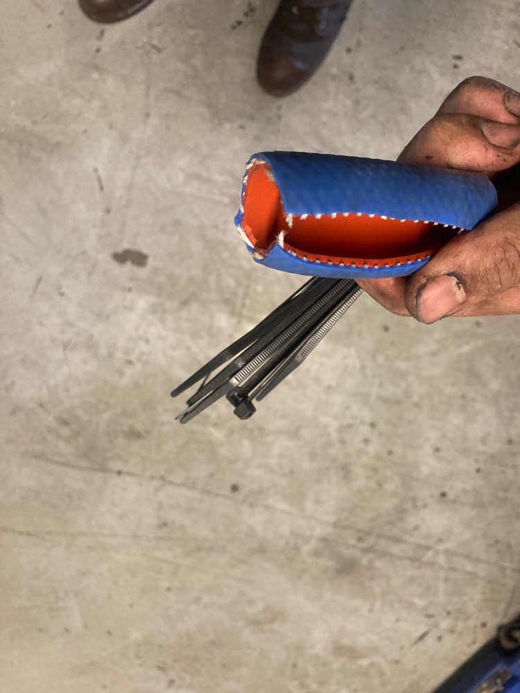

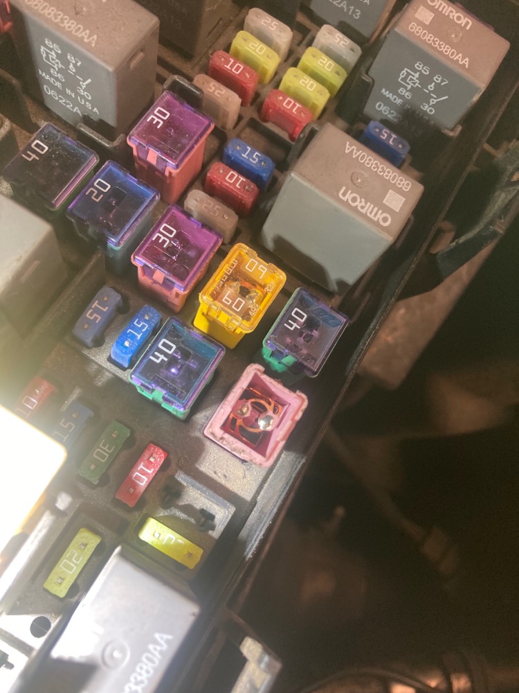

Had a Dodge 2500 Cummins come in today. Customer said they were driving and it just die, and wouldn't start. Pushed it in, had no com with the PCM and a bunch of other communication codes. Checked the wiring diagram for the PCM and noted the fuses. J3 a 30A J-case was blown. Put another one in and it blew immediately. (no I was not going to ship it without finding the short if it didn't blow). Unplugged the PCM and checked resistance to ground of the shorted wire (to make sure there wasn't in internal PCM short) nope, still shorted to ground. Plugged the PCM back in, and then all of the sudden... no short! Great... now I have to find it! I put the fuse back in and started wiggling the harness, eventually I heard a slight arcing noise above the fuel filter. Pulled the harness back and sure enough had rubbed through on a trans cooler line. Repaired the wire, wrapped the loom back up with Tesa tape, added a rubber bushing, and boom truck is on the road and I can sleep at night knowing it isn't gonna come back!

Well done, no parts thrown at it and professionally fixed.
