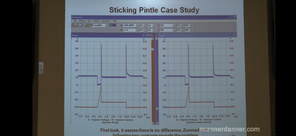

Hello would anyone have a waveform for a 90 Chevy tbi injector
5 years 1 month ago #51623 by Noah
Replied by Noah on topic 90 Chevy tbi injector
Taken from this premium video.
