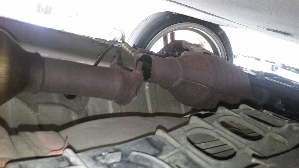

Im having a problem with my car but i dont know what the problem could be. The car only starts up with a jumpstart and stays on when jumpstart cables are disconnected after providing start. Second problem is when the car starts up its making a loud noise once cranked up because when i look under the car i see a part broken off but i dont know nothing about cars or what that defective part name is. If you can please help me i would really appreciate it.

It sounds like a defective battery . You can verify this by checking charging voltage. You may have a parasitic draw that killed battery but that test must be done with a good battery. As far as what's hanging underneath a picture of it would help if you can't get a picture than maybe a detailed description of the area and it's shape may help

9 years 7 months ago #7150 by arortiz3033
Replied by arortiz3033 on topic Re:2000 Corolla VE
i took a picture of underneath the car.
9 years 7 months ago #7155 by Ben
Replied by Ben on topic Re:2000 Corolla VE
That is you catalytic converter it has broken from your intermediate pipe that will require a sleeve to be welded in . Depending on your local shops they will likely charge around $50 to repair it but this can vary from shop to shop

9 years 7 months ago #7159 by Andy.MacFadyen
Replied by Andy.MacFadyen on topic 2000 Corolla VE
It looks like you need to spend money on the car to keep it running --- apart from what has already been mentioned it looks like it also needs tyres you should really find local help and get a estimate on cost.
