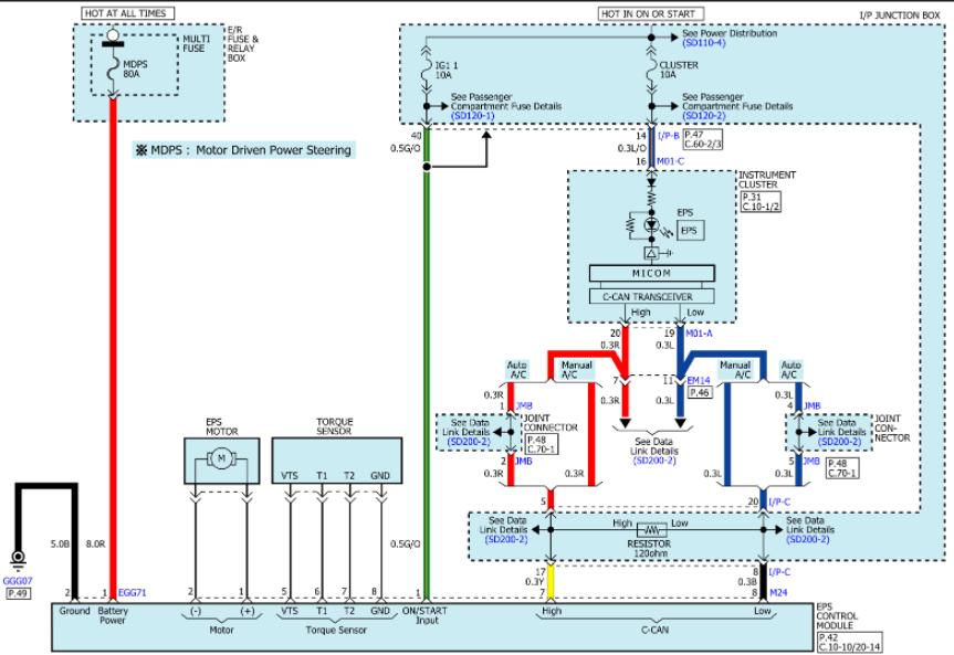

5 years 1 month ago #51821
by ScannerDanner
Don't be a parts changer!
Replied by ScannerDanner on topic Hyundai i20 2011 Magna Steering Hard/Grinding Noise/EPS light ON!!!
Post the wiring diagram of this system if you have it. I need to see what we are dealing with.

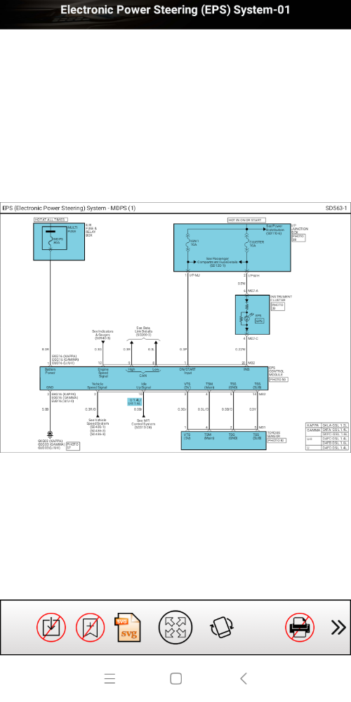

5 years 1 month ago #51833
Replied by Tyler on topic Hyundai i20 2011 Magna Steering Hard/Grinding Noise/EPS light ON!!!
Finding service info for your i20 is a little tough, as they never sold it in the States.
But it sounds pretty close to an Accent. I found this MDPS diagram from a '14 Accent that halfway matches your description:
It sure sounds to me like the EPS module is attempting to run the motor, finding something about its operation it doesn't like, and defaulting to a failure mode. The grinding noise suggests a physical failure, rather than an electrical one. Are you able to get fault codes out of the EPS module?
Reading more service info suggests Hyundai doesn't advise servicing the motor or the module separately. Any kind of problem external to the steering column assembly means you get the whole thing. :silly: The only other check I would advise is lifting the front wheels off the ground and inspecting the front suspension for binding or other failures. Anything that could make the EPS motor work harder than necessary. With the wheels off the ground, try to turn the steering again. It should now move freely.
