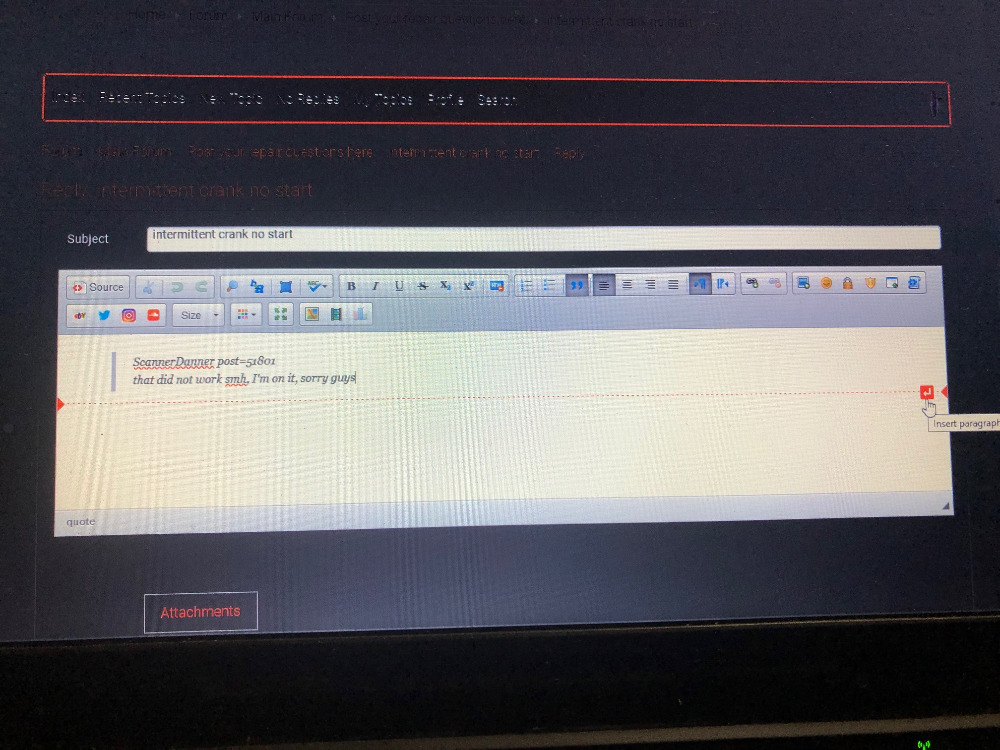

4 years 11 months ago - 4 years 11 months ago #51805
by Matt T
Replied by Matt T on topic intermittent crank no start
Clicking the red Enter symbol has been working for me. Far right in the picture with the mouse hand over it.that did not work smh, I'm on it, sorry guys
Last edit: 4 years 11 months ago by Matt T.
