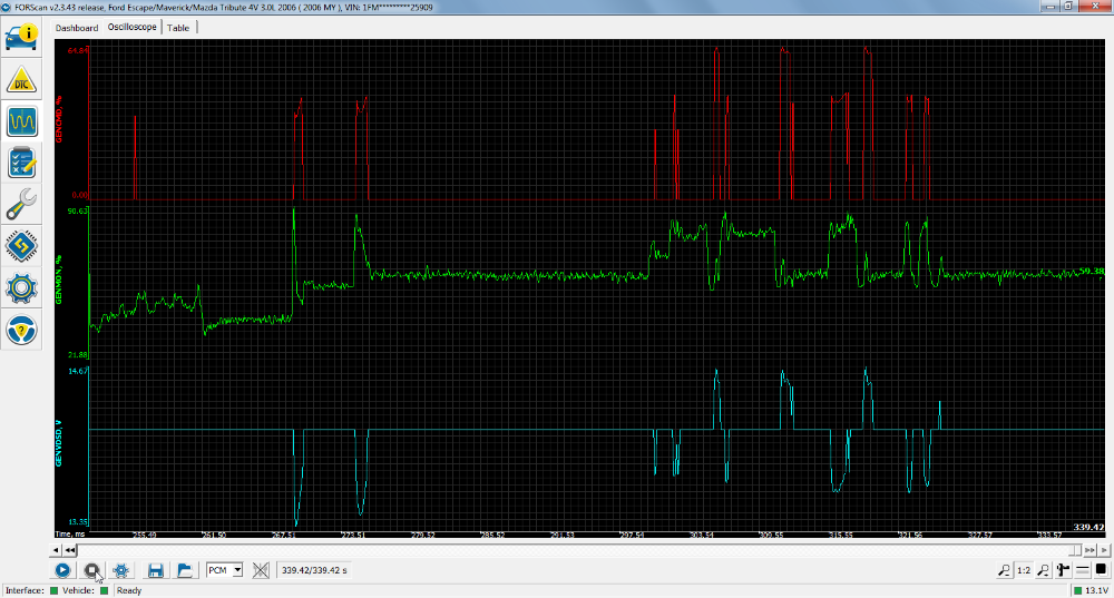

I do a longer GenCmd pulse which is similar to what he sees on his scope during some demand. Here is one where we switched on the AC in the driveway and got more demand. I do see the command pulse changing, so I think the wiring is probably OK, but it just continues to lose the GenMon signal in the ECM after a short drive and is OK again after removing battery cable for 5 min.
1) Could be the mon signal isn't really going away, but when it does the overcharge, the ECU quits displaying it?
2) is it normal (acceptable) on 2006 for the GenCmd pulses to be 15 sec min and up to more than a min apart?
3) Where do I go next?
I did do more testing last night and did driveway test again for 15 min, all looked good. Drove residential for 30 min, stayed working fine.
I added a pretty good load with lights on and intermittently holding window buttons closed to see the signals change. I think it looks fine from ECU standpoint here and voltage stayed good on multimeter. Sorry I didn't change background color on this test...

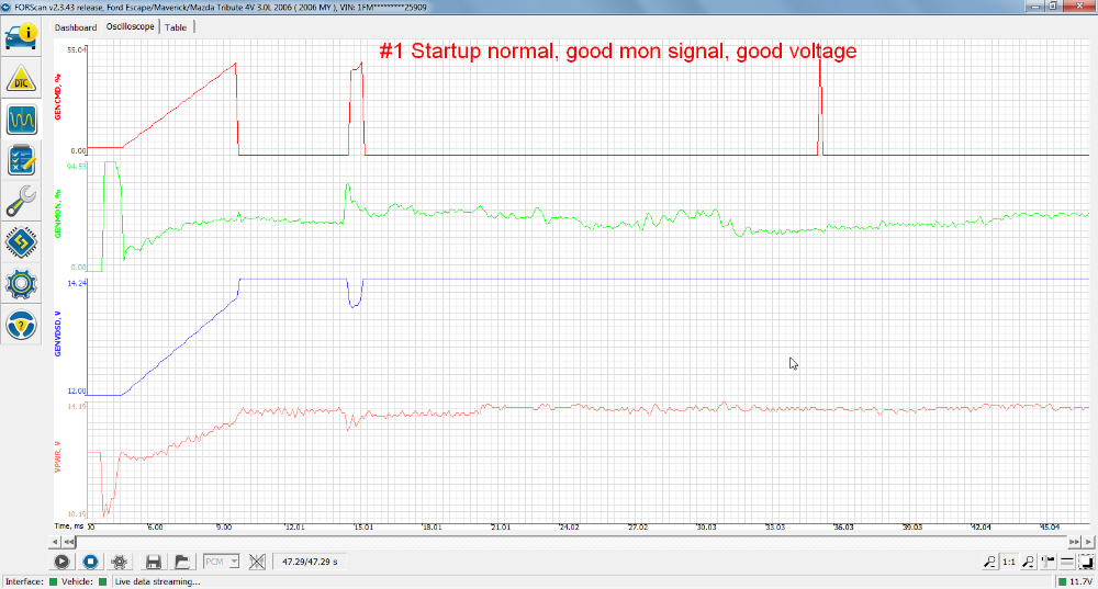

Car is in proper charging condition. Here is a 'normal' startup. Cmd and Mon signal look fine, Voltage reported fine.

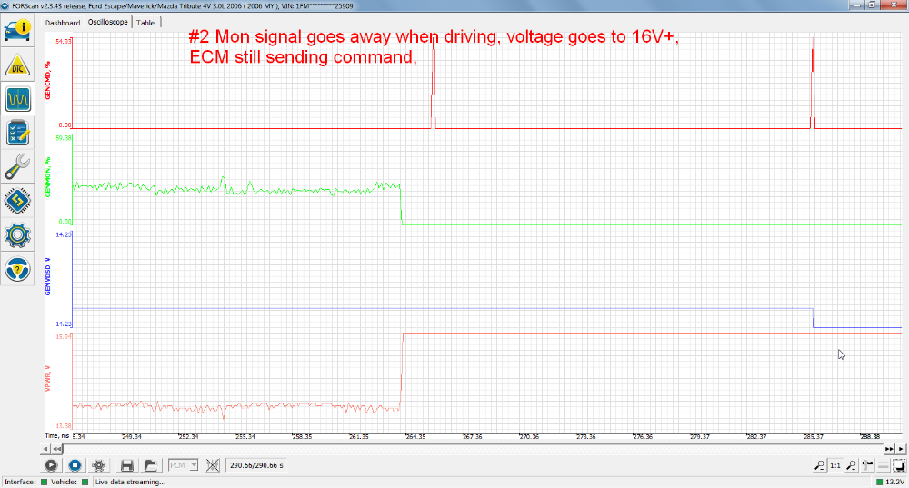

When driving for 15 min around local area, issue happens and dash goes away. Caught on Forscan.

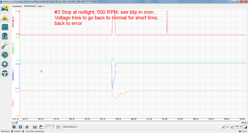

Headed home and can see when RPM dropped low, it tried to start working, but only for a very short time.

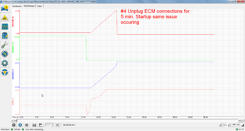

Got home, shut off, and disconnected all connections to ECU for 5 min. Figured if problem went away, ECU was probably to blame. Started back up,and same no mon, high voltage issue.

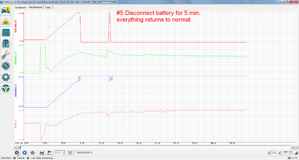

Disconnected battery for 5 min, and back to operational. My gut says it has to be a bad regulator in crappy rebuilt alternator. So I guess another 3 hours of labor and a Motorcraft alternator is next, right?

When it is in the 'bad' mode, I can see the voltage jump around from 15 or 16 at idle to 18V when holding RPM at 3K. When it is working correct, it stays at 14V no matter what RPM is at.

In case anyone else stumbles on this later, the issue was the alternator again. The Autozone one had a voltage regulator issue also and was replaced with a Motorcraft and all is back good except a much lighter wallet... When the bad one was left stopped in the overcharge condition without disconnecting the battery, it would drain the battery in a day. Just adding the solution for future reference.
